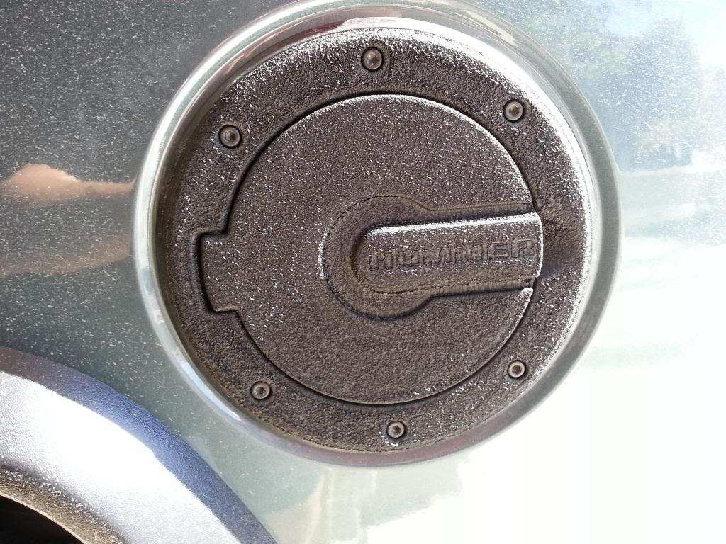

I looked for a while at aftermarket locking doors but the price on those is too ridiculous for me.
This is what I ended up using on mine for a permanent coating:

Still holding up like I just sprayed it. Thinking about doing some other parts with the same spray.

How did you do it? Did you just sprayed it on bare metal? How did you clean rest of chrome remaining?
Old Mar 15, 2015 | 08:37 PM
LoJac963's Avatar
Joined: Jul 2011
Posts: 2,357
From: Surprise, AZ
I just scuffed the hell out of the chrome with a 3M scuff pad. The wrinkle coat you have to do a few very wet coats for it to work. Reading the instructions on the can are a must! I think it looks good, reminds me of the old school valve covers when they were wrinkle coated.
