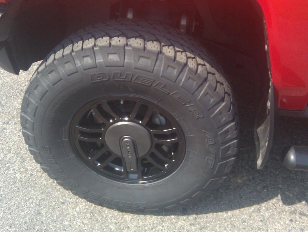

How did you go about painting the center caps? I envision the paint chipping around the edges where the cap has to be pressed onto the wheel......

I took the caps and scuffed them up good with some 1000 grit wet/dry paper. Then I washed them with soap and a rag, then rinsed clean. Dried them good and and painted. I had some leftover rustoleum hammered black that I had used to paint my lower front bumper. I figured what the hell lets just try it and see how it looks. Sprayed 3 coats with about 15 minutes dry time between coats to make sure caps were completely covered. After last coat I sprayed on some duplicolor acrylic enamel I had laying around for some extra protection. Let dry for 2 hours then slapped on truck. The color I used is not as black as the wheels but it matches the tires and lower bumper. Haven't decided if I will keep them or find a darker black. Not sure I guess what color a perfect match would be. I can't imagine there would be any scratching the caps go on and off very softly without any struggle. Besides if there were any scratches you would only see it when the caps are off. I have popped them on and off a few times, I will take a close look and see if there are any marks.
