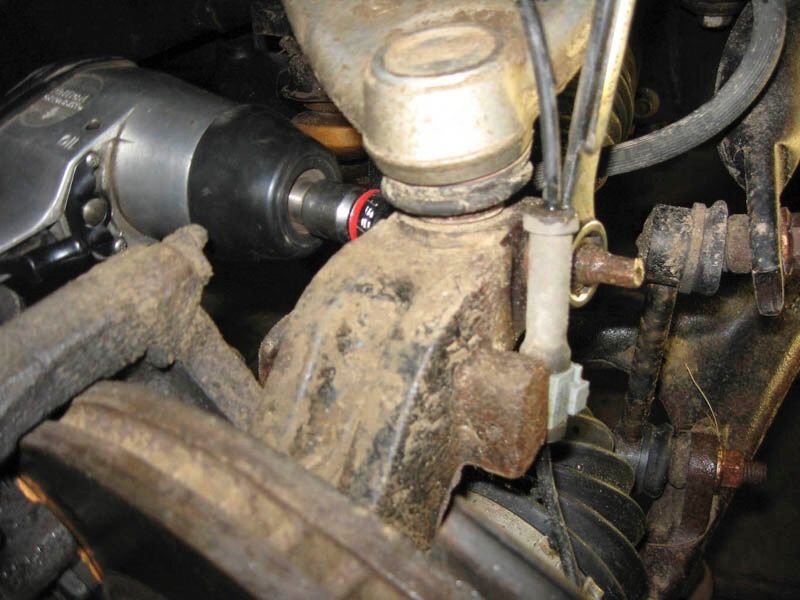

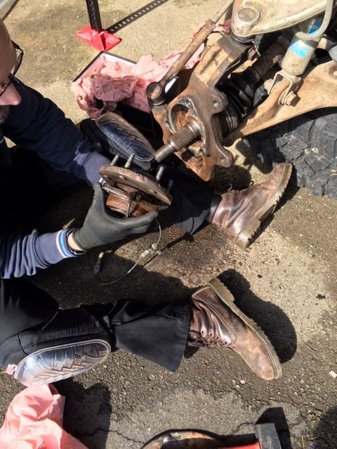

It was time after 13 years to change them....
damn they where rusted...now the new ones in, both sides.

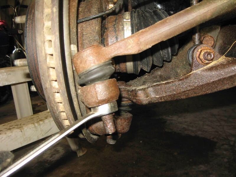

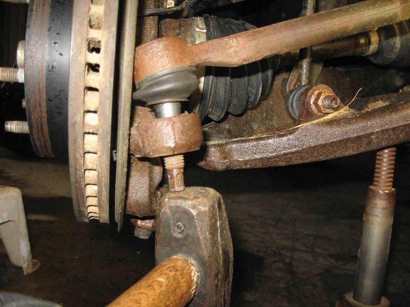

Oh yes, i did my ball joints too, damn where they hard to get out. had to flex the mushroom-had away first .
And after long work....
They are in

Thanks guys, it was a hard job with the hubs do to all the rust, but now it's all clean and new.
The Ball joints came out easily after flexing that bordure of mushroom head away, the ball joint press did the rest.

Nice work! The only thing I would do different:Is not use a bar jack(aka:farm jack) and not have my leg and foot under the control arm during the repair.
