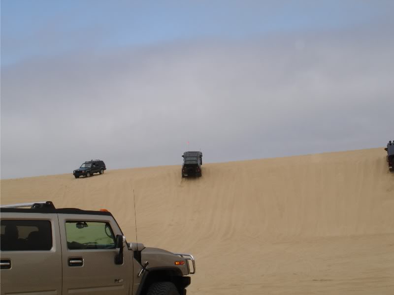

I'm not sure the actual measurements but yes they will fit (315) without touching the t-bar.
Here's a jump.

stlH3: Yes I know you were relaying the dealer line. You have confirmed for me my suspicion, when your fron tires left the ground the way you described you may have over extended your front shocks and gave the front axles a snap flex??? Might a happened regardless? Get front extensions or longer travel shocks. I would also agree that the T bars can be over adjusted, but I do not know your specific details.
Qyestion: Did the dealer lower your T bar setting after the repair?
Golden Shellback: Silver Lake Sand Dunes, looks familiar????

ORIGINAL: Doc Olds
Pismo Beach, CA. same trip as this one

I was just gonna add Idaho?? But I'll also add, Pismo Beach. Look at the Bus rockin!!!!!!

and nothing broke - both t-rods cranked. the shocks keep the front wheels from dropping farther than they should, so i personally don't see a use for shock extensions.
