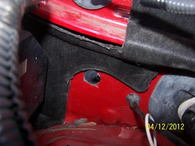

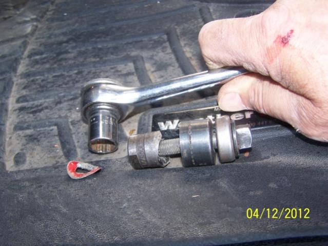

well,heres the hole,you add the wire,,,s
hard to drill in there. the square plugged hole must be for clutch stuff so stick shifters skip this!
my small starter drill stuck in the corner so thats where i did it. then i used a larger drill and finally a 7/8 hole punch. if you can center in the square u wont have to go thru 2 layers as i did. the gunk around the hole is putty i used to start the hole punch,long story.
ill find a grommet or use more of the sticky putty,WHEN i find just one of the many heavy red/blk wire harness i know i have,,,somewhere.

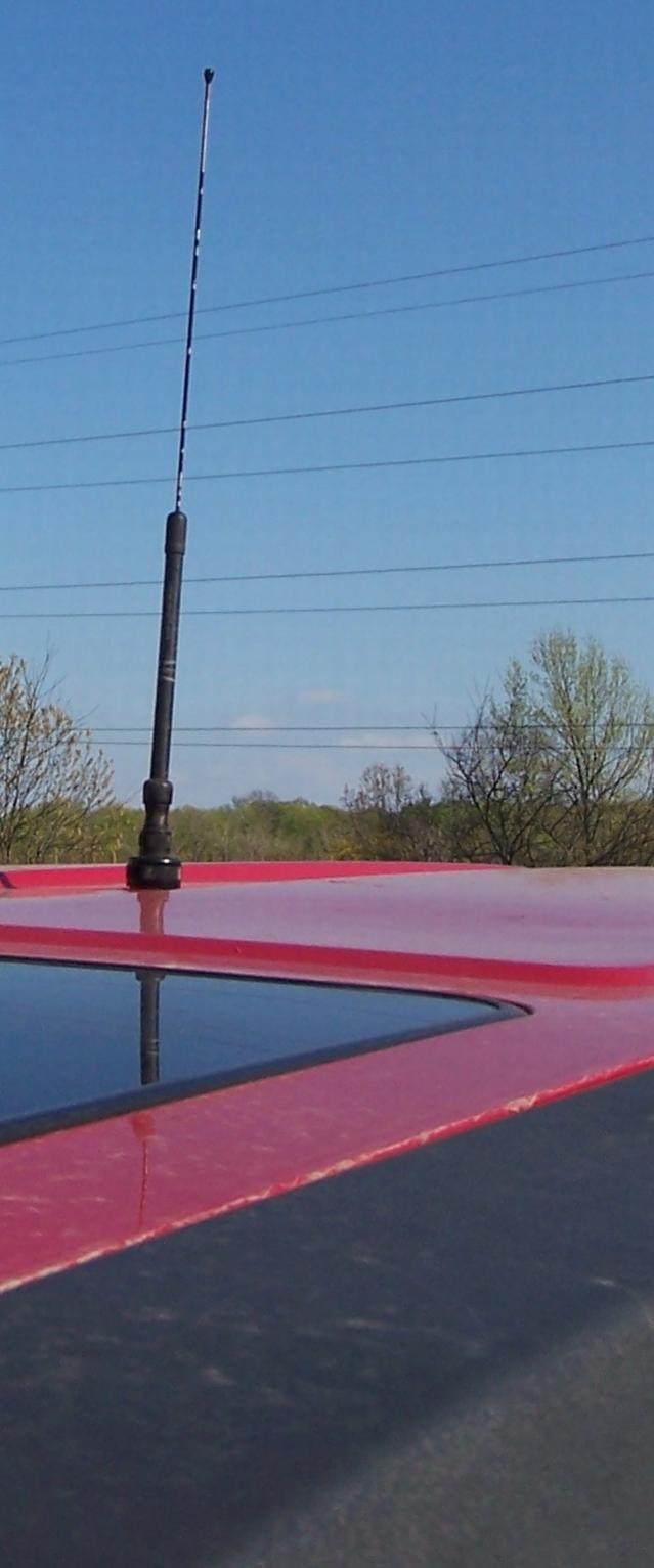

finally,the dual band ant where it belongs,right in the middle of the roof. well it didnt make it
a good workout today. wires manyana
Attached Thumbnails the fix; wires thru firewall-az-hole-punch.jpg   the fix; wires thru firewall-az-hole-outside.jpg   the fix; wires thru firewall-az-hole-inside-1-.jpg

taking all day for 1 pix/
oh,the ant is for the radio that made the wires necessary!

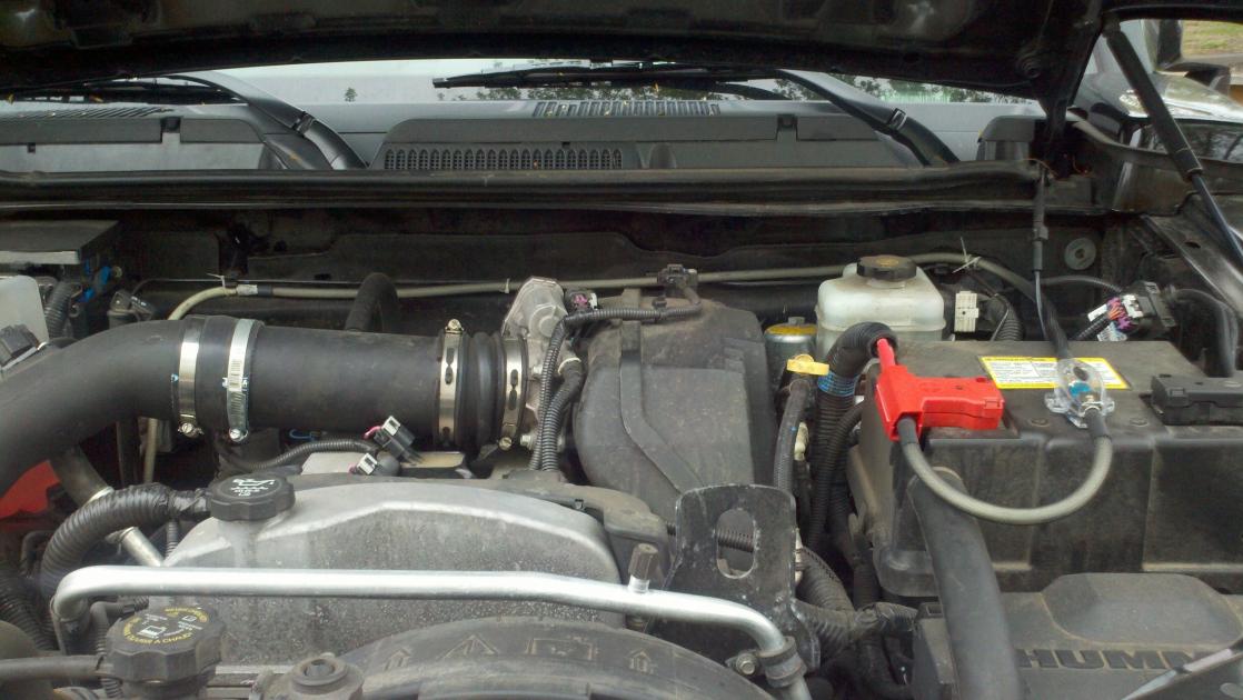

I had to drill a hole through the firewall last month when I installed a new car stereo. For me the best place to go through was on the passenger side. This was b/c I found a nice smooth spot to drill that was free on both sides and it was close to the amp (the amp is under the passenger's seat). I used a unibit from Harbor Freight and it went through it like butter.
I attached 3 photos. The first is the inside directly under the glove box, the 2nd is the outside which comes out below and to the right of the PCM, and the 3rd is just a picture of how the wire goes to the battery (you can see it along the top of the firewall).
Attached Thumbnails the fix; wires thru firewall-h3_firewall_hole_inside.jpg   the fix; wires thru firewall-h3_firewall_hole_outside.jpg   the fix; wires thru firewall-h3_amp_wiring_under_hood.jpg
