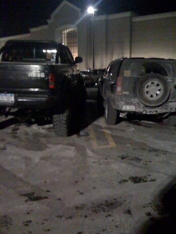

the only pic i can upload now is the one that made me want to lift it
thats my friends 98 ram 1500 with 5" susp. 3" body lift and 38x13 tires the thing is a beast
