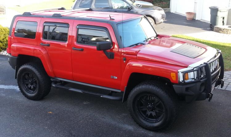

Just picked up a 2007 and have been making the "to do list". Auto Start is on the list and I see there are a couple of varieties. I see the "programable styles" and the pre programmed styles.
What do you suggest? Is there an advantage to one or the other?

Welcome to the forum and congrats on picking up your rig.. Looks sweet. I dont have a autostart, nor will I put one on. But just wanted to welcome ya and keep us posted on any mods.. We love pics.
