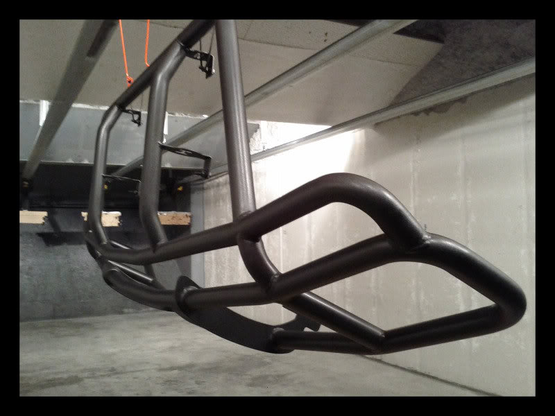

One thing I didn't like was the finish. It came in semi-gloss black. Too shiny for me. I took it downstair at work and scotchbrite-d the entire surface. Wiped with min spirits to remove dust and finger prints/oils. Then rattle can sprayed it with textured Satin Black Rustoleum. Several coats. Took two cans. Looks and feels like the OEM guard finish.
Welds look pretty good.

Carrying this thing around, it is LARGE. And feels VERY durable.
Up to the level of RubberDuck? No way. I wouldn't want to push over a 3" sapling. I have no illusions about my new brush guard. It is for brush. In that regard I feel it will fulfill the VAST majority of H2 owners end use.
