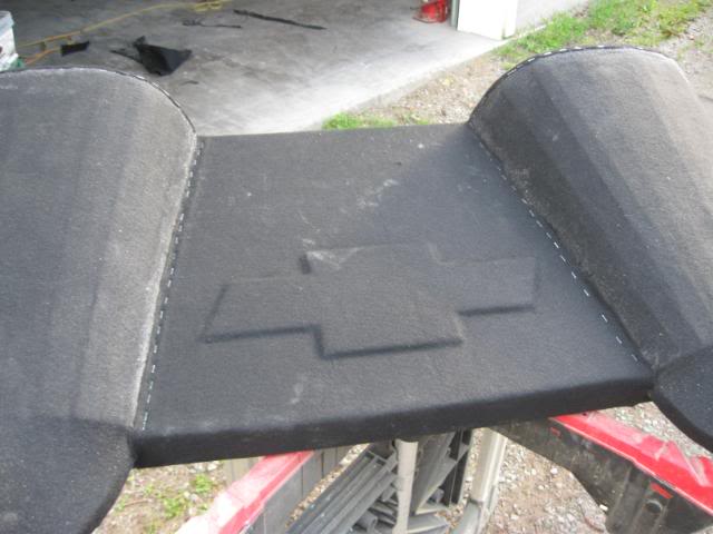

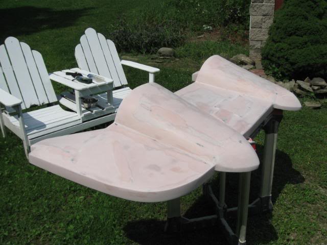

i don't know if any of you guys are into making boxes but if you are, i just built a tonneau cover for my old classic. the construction would be the same way just would look different as you would have a different shape,
it wasn' really hard to build, more time consuming imo
you can customize it too?
if you have questions let me know, i have a weekend and some nights into it.
