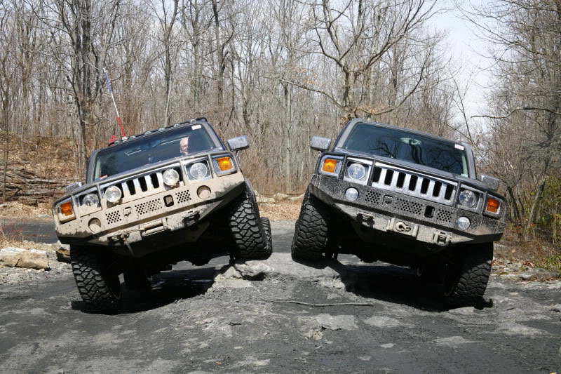

Here's a pic..... gotta be worth like 100 words or so.
Tainter w/315s on the left, Doc with 305s on the right, both are Mickey Thompson MTZs.

Old Sep 5, 2014 | 03:06 PM
Talking
Don't make me pull out that other picture Doc
