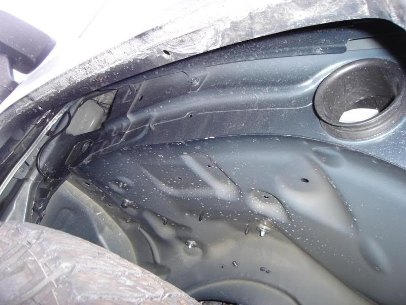

I think those "intake" covers are really exhaust covers. You can feel hot air coming out of them. You can do that and you can see as the water gets to them but I like the extra margin, just in case. I don't ford deep streams on purpose.

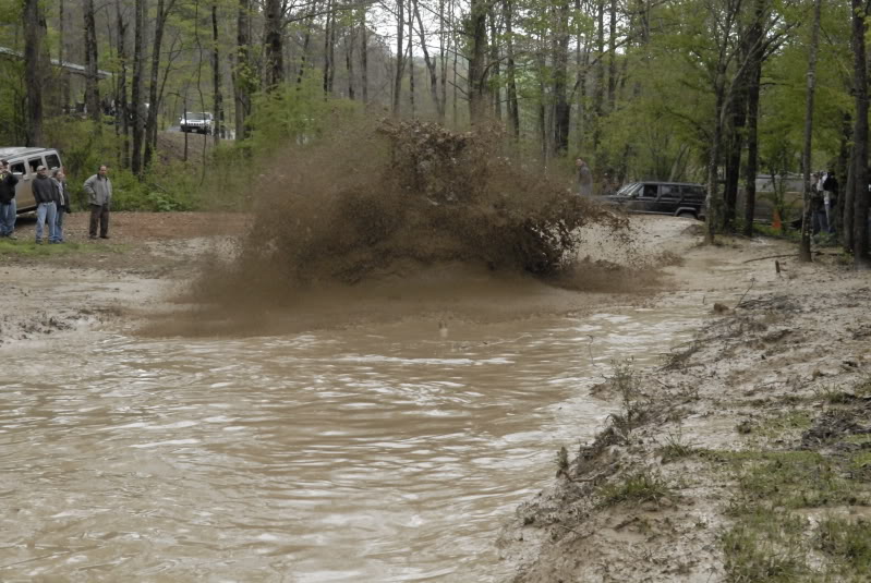

The only time I had to run thru some water was with an incoming tide and the choice to drive 60 miles back the way I came or run the last 1/4 mile. (dumb) It was 20 miles back the way I came on the beach part with the tide coming in so I pressed on! If I slowed down the incoming waves washed the sand out from under my tires and I had that sinking feeling so I kept a steady speed. Glad I had the snorkle. Went straight to the wand car wash for a long rinse.
Video
Don't try this or keep moving if you do.
I like to add a few shots of people that don't think the way I do when this comes up.

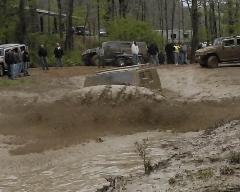

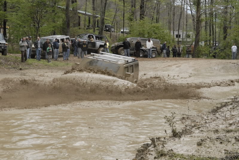

Here are some guys with older machines that are susceptible to flooding out.
I watched these guys flog it thru here then drove calmly thru it and just for grins backed thru it a second time.

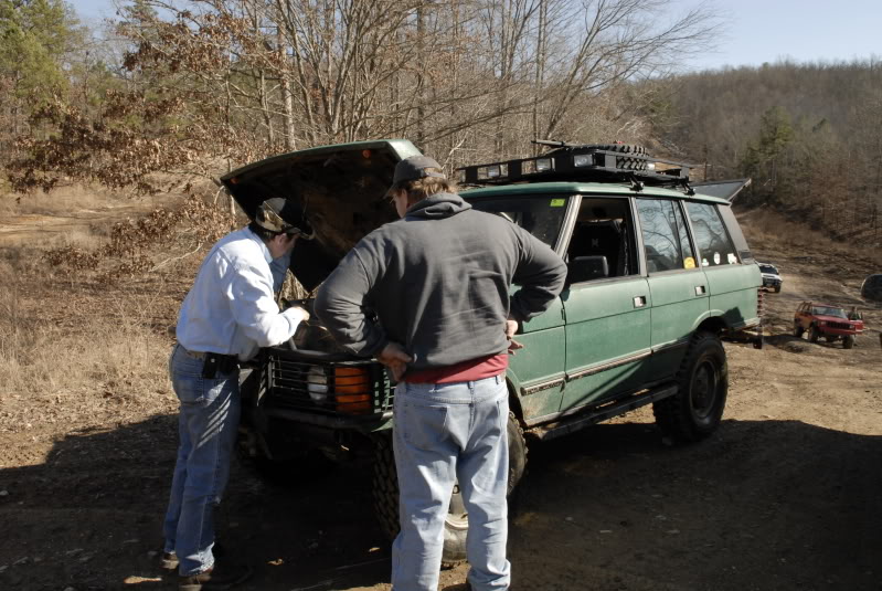

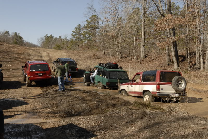

All of them are long time friends but flooded ignitions and air filters stopped them all. They had to go to town to get new elements.

It's ok, the guy on the right is a Rover mechanic!
