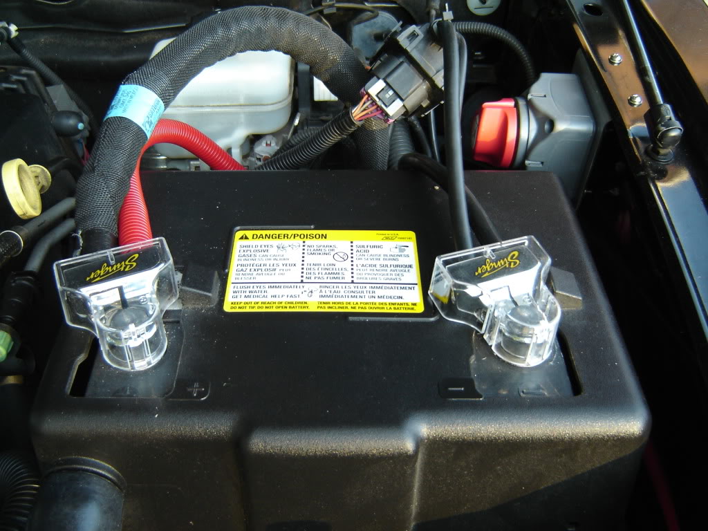

Check your battery connections, and if you have not seen the many threads about immediately hacking off the OEM connectors and replacing them with solid aftermarket terminals, search around. Stinger and Tsunami are popular, I used Stingers and have never had a voltage problem in the years since.

imo the minute you cut the factory crimp on batt cables you have DOWNGRADED your system.
the conn have nothing whatsoever to do with the voltage the generator delivers. thats determined by the field voltage controller in the computer.
if the conn are actually bad/loose you could get glitches in the system,BUT i think you would see/hear starting trouble , clicking immediatly with any bad connection.
if you never see 15 v,you have gen/control trouble.
my digital readout hit 15.2 today briefly on startup, always does.
edit, last yr when we were discussing the h3 gen,i monitored the volts with hi beams on,air cond at max,radio blasting,AND a 65 amp external load.
only with the 65 a load did it pull down to abt 12v, never got a light of any kind. when working right,its a great system. even the stock batt terminals are good if used properly. the problem is they can be over torqed and distorted by heavy handed wrenchers!
