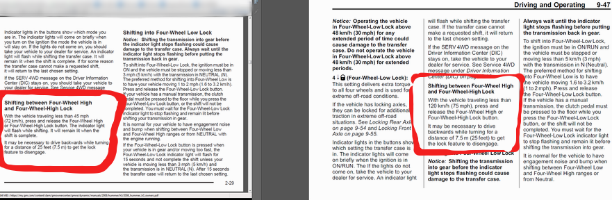

9-46 Driving and Operating Your HUMMER H3/H3T
Shifting between Four-Wheel High and Four-Wheel-High Lock
With the vehicle traveling less than 120 km/h (75 mph), press and release the Four-Wheel High or Four-Wheel-High Lock button. It may be necessary to drive backwards while turning for a distance of 7.5m (25 feet) to get the lock feature to disengage.
Actually, according to the 2008 Owner Manual(2-29), you must be driving below 72km/h (45mph) to shift between Four-Wheel-High and Four-Wheel-High Lock, not 120km/h (75mph). My '08 will NOT shift above 45mph.
I've never tried it over 10-15mph myself. Never had a reason to. I keep it in 4Hi unlocked on the street (all the time) and 4Hi Locked or 4Lo when OffRoad.
Those quotes above are directly from the 2010 HUMMER H3T online copy of the Owners manual (9-46 to 9-48). I downloaded it from General Motors yesterday.

HUMMER H3/H3T OWNER'S MANUAL
2008 on the Left - 2010 on the Right
