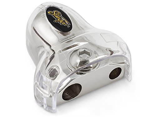

The OEM Battery Terminal Connectors are absolute junk. Yes, a poor connection to the battery can affect anything and everything electrical. Cheap and easy way to rule those out permanently is to replace them with an aftermarket set, like Stingers or whatever brand you want. Search it out, there are threads on it. Research what size you need, brands, then Ebay or online source.

I do not remember the model # or wire gauge off the top of my head, and I do not plan on looking it up. Measure the width of the battery wire, on google there are many conversion tables that tell you if your battery cable is ______ wide then the wire gauge is _______. Then pick a stinger terminal with that size option.
Mine are more than what you need, they have multiple w/ two large wire openings each to accommodate my winch wiring.
I would hack those POS OEM terminals off right NOW, forget that go diagnose something first. It is common knowledge that the OEMs all cause an eventual electrical issue (it is not if, only when). Always fix the easy stuff first. Battery Terminal Connectors are cheap and easy. If that does not correct your issue, then go looking for other problems, like #2 on the list, a wet BCM.
Some Stingers come in Positive and negative models, you need one of each.
These are popular: Stinger SPT55301 PRO Series Battery Terminal Works
