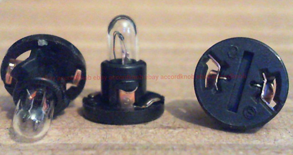

If you need to order more bulbs again, here is where I bought mine.
You get five bulbs and sockets for $6.99
Five 5 Bulb for 2005 2010 Hummer H3 Heater A C Controls Window Switches Mini | eBay

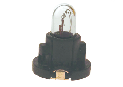

no soldering, the back of the bulb socket has a slot in it. a 1/4 of a turn left with a small screwdriver and the bulb comes out. place the new bulb in and a 1/4 turn to the right and the new bulb is seated. the bulb and socket are one piece

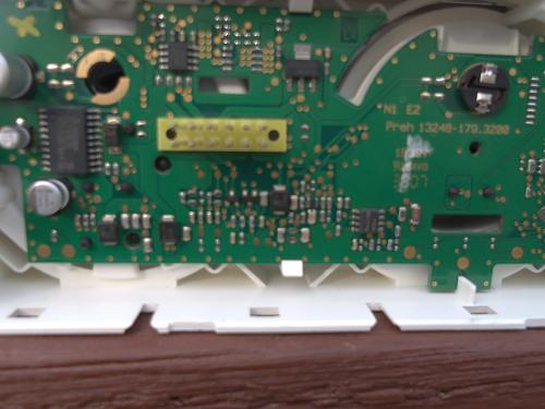

if you look at the circuit board the open hole on the left is a bulb removed, on the right is a bulb still in place. there are no bent over wires, the contacts on the bulb and socket make contact with the copper colored area on the circuit board completing the circuit. it is literally plug and play

I cant open that pix of the circuit board. I remember now my previous experience with this stuff. they called the mount a "carrier" and it plugged in the board after I pushed th e wires thru and cut them off,bent over,no solder. now I will search my junk to find one!!

this is the circuit board

All that is totally unnecessary
Major Tom has the correct bulb and socket and it works perfectly
