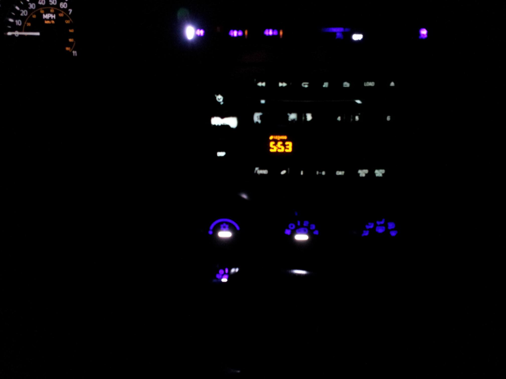

Old Feb 10, 2012 | 07:56 PM
funv007's Avatar
Joined: Feb 2012
Posts: 25
Default h2 uv and white
H3 uv and white
