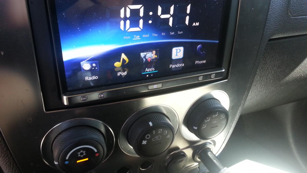

The 3 ***** with climate control. All 3 are functional but the backlighting lights on 2 (middle and right) went out. The orange in the middle still works. So maybe it's a little bulb or LED or something.
I was wondering if anyone knew how to fix this? Simple part swap or just bulbs, etc
and maybe the part #s.
Thank you.
- Eric

Alternatively my local car stereo shop said they can fix it for ~ $80.

Here is a link from another forum, but the same guy. He shows you the steps.
Hummer X Forum • View topic - Instrument/Interior lights
Sadly, the e-bay guy I have bought bulbs from is sold out

12v,60 ma. bulbs are not hard to find. many electronic distributors will have them.

I got a set of bulbs off ebay for $15, took a couple hours but I did it.

they are less than a dollar, MCM had some for 54 cents. there are dozens of electronic distributers to choose from, shop,etc.

I just replaced mine today (15minutes) with led bulbs. Bought the led bulbs on ebay 6-6.99 free shipping.
