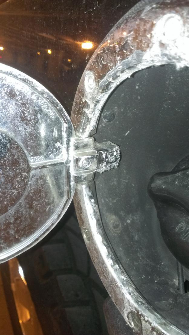

the plastic cap on mine seems recessed in...
Attached Thumbnails Chrome Hummer Fuel Door cover..weird question-imag0921.jpg

Any clue as to whether I can purchase a replacement cap and spring? I kinda ruined the cap with trying to pry it off; got holes poked all in it. was able to pull the cap forward but not off in order to expose the spring.
