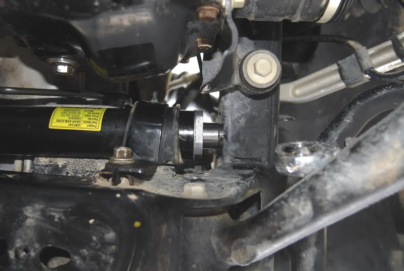

I would throw in that if your steering rack bracket bushing is destroyed or just never tight by design, I guess, the alignment is changing all the time. It's like having a more flexible tie rod, which OEM are to a degree is why they get bent and then broke at times when getting knocked around and larger heavier wheels and tires add to that affect.
If you had upper a-arms replaced it would seem that would fix bushings and ball joint on that.
Like Doc says, it's time to go somewhere else but point out the bushing issue and have it checked.
I don't know about the wobble issue, you might try grabbing the tire and push pull at 3 and 9 angles and top and bottom. A bad hub bearing could cause some of that.
Of course an out of round tire could also be a factor but would seem to do it all the time.

Here is another one at about 10,000 miles.
