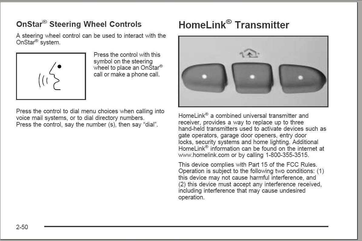

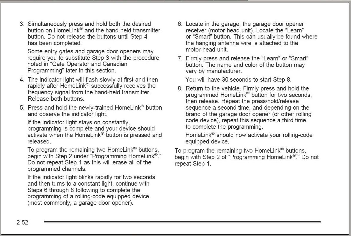

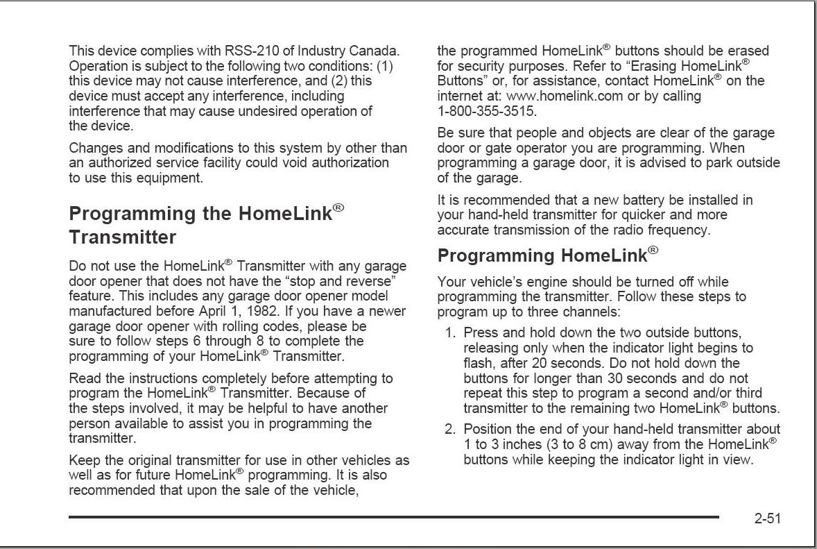

Okay, Here is the Homelink "MANUAL" part. I'm pretty sure you have to do the GATE OPERATOR AND CANADIAN PROGRAMMING part!! I kinda remember that's what you have to do with the rolling code systems!!
