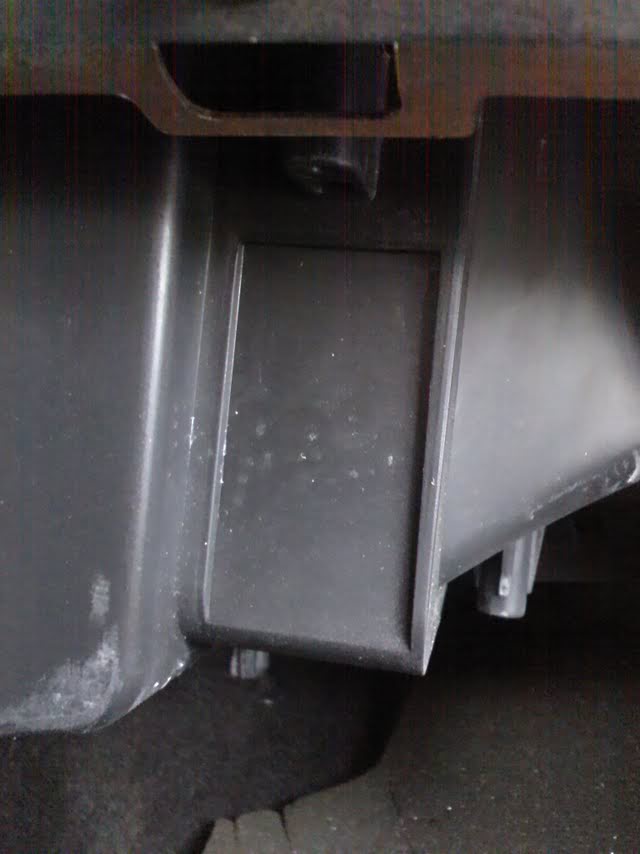

BTW... if you did have a model that has one...
remove the large curved plastic under the dash on the passenger side.
Locate the 3 bolts that hold the glove box on... locate the middle one...
there will be a blank approx 1.5 inches wide....
since you don't have one... you will see the bosses where one could be tapped in...

I will take a picture for you tomorrow.... a picture will clear it up for you, 100%
I would say that unless you have a 2003 made in 2002 then there is no chance you have one... although some Chevy/GMC owners have cut the slot out and added their own.

If you have one this will not be blank... it will be removable...
if you take this all apart and modify it, a filter will fit. You will just have to make a cover after you cut out the blank.

Thanks for taking the time to post a pic. Mine looks exactly like the picture and no way in hell is the filter that I have going to fit in there. I'll bet the one they gave me is about the size of a sheet of paper.
So it appears the filter goes on the pressure side of the fan, I would have guessed it to be on the inlet side. Dawg you've been a big help, thanks.
