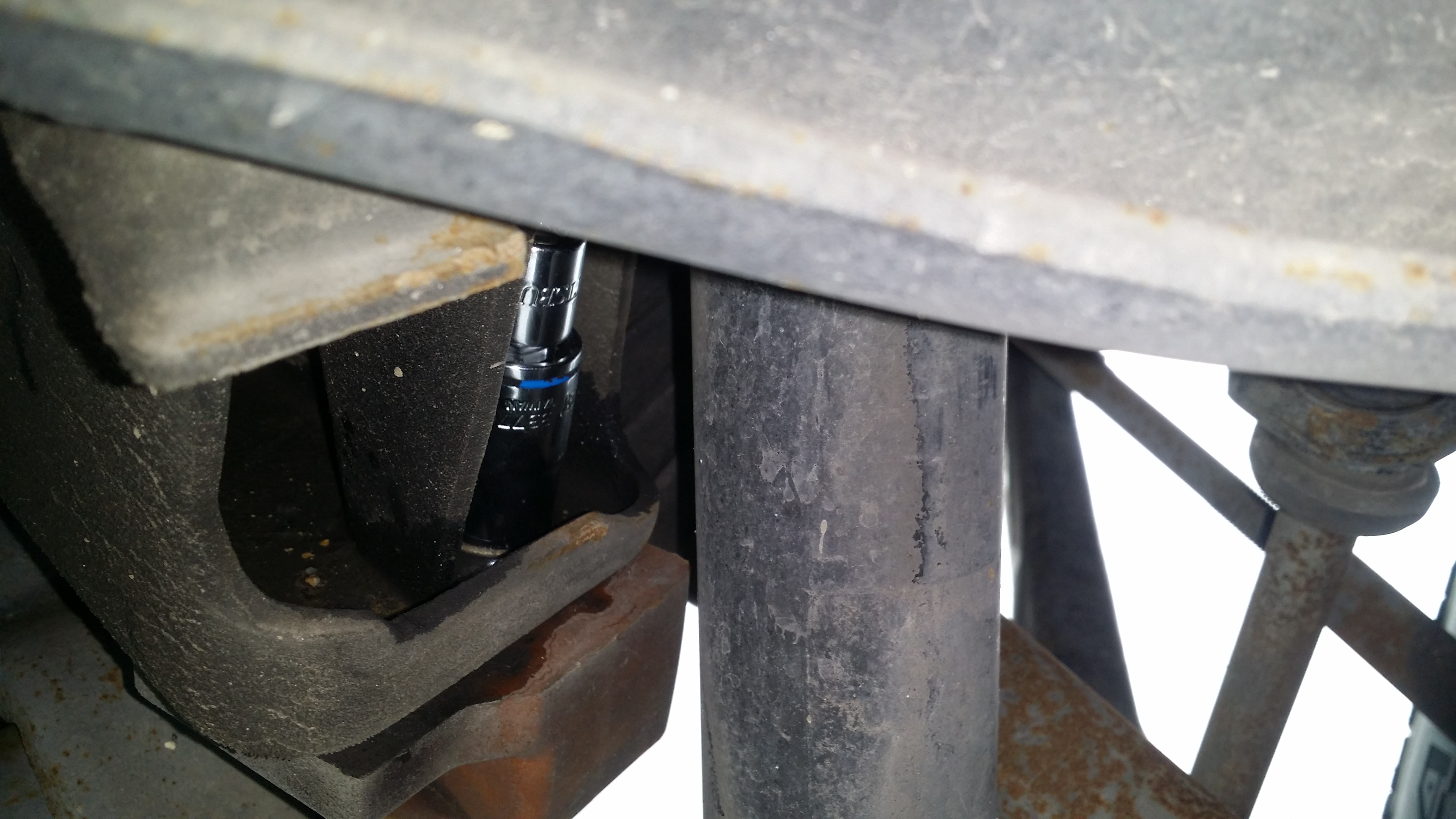

3. Locate the nut that secures the bumpstop & loosen it. This does not require a breaker bar.
4. Remove the nut & bumpstop. Clean the threading on the nut.
5. Replace the bump stop. There is a small metal tab across from the threaded bolt. This doing into a small hole & prevents the bump stop from turning.
6. Place the nut back & use the socket to secure the location. Once the threaded bolt is inserted, use the extension to thread the nut to the bolt by hand. This is much easier than using the socket wrench. Once you cannot turn the nut by hand, finish tightening the nut with the wrench. Remember to always apply pressure to the bump stop tightening it to keep that metal tab it's slot. If you don't, it will move around & you'll have to loosen the nut & start over.

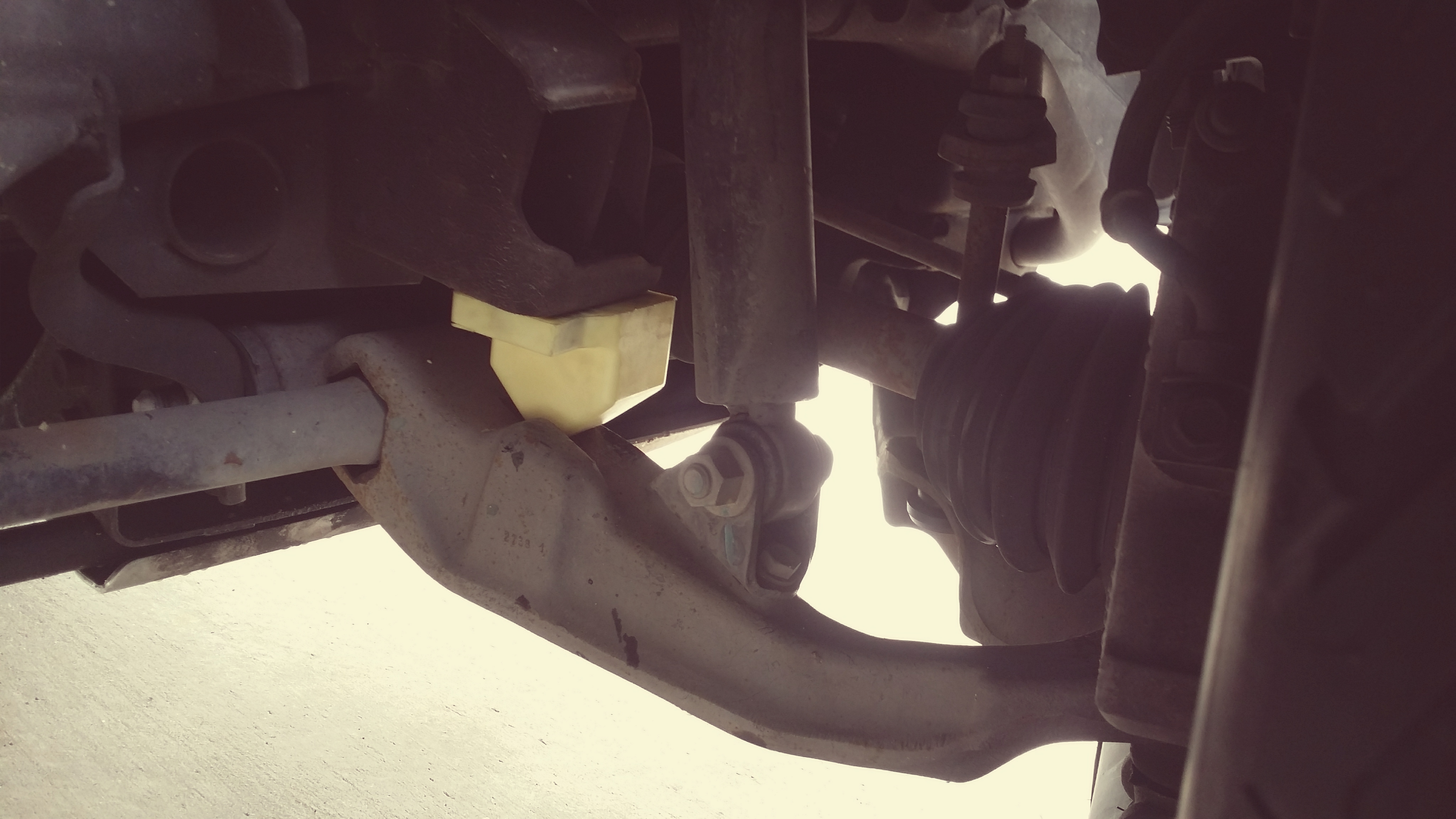

7. Jack up the vehicle, remove the jackstand & lower it. You'll notice how the bumpstop sits against the lower control are while at rest.
Here's a picture diagram.

The picture w/ the mounting location pictured without the bump stop is from the driver's side. That's why it looks reversed compared to the rest of the pictures.
