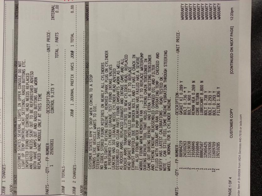

Sooooo.... I got her back today! She is running like a champ now!
Figured I would share the long list of mechanical problems they fixed. Enjoy.
Attached Thumbnails Bought my 06 a week ago and I'm regretting it now $$$-20140207_140746.jpg   Bought my 06 a week ago and I'm regretting it now $$$-20140207_140801.jpg   Bought my 06 a week ago and I'm regretting it now $$$-20140207_140815.jpg   Bought my 06 a week ago and I'm regretting it now $$$-20140207_140837.jpg

Awesome they fixed it for you. rightfully so though. The tic and louder than usual exhaust was the cracked manifold, I have one right now and i wish Gm would pay for half of mine!!
