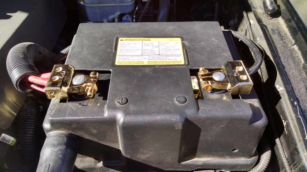

Here's mine; Raptor brand, purchased from AutoZone, about $12 apiece.
