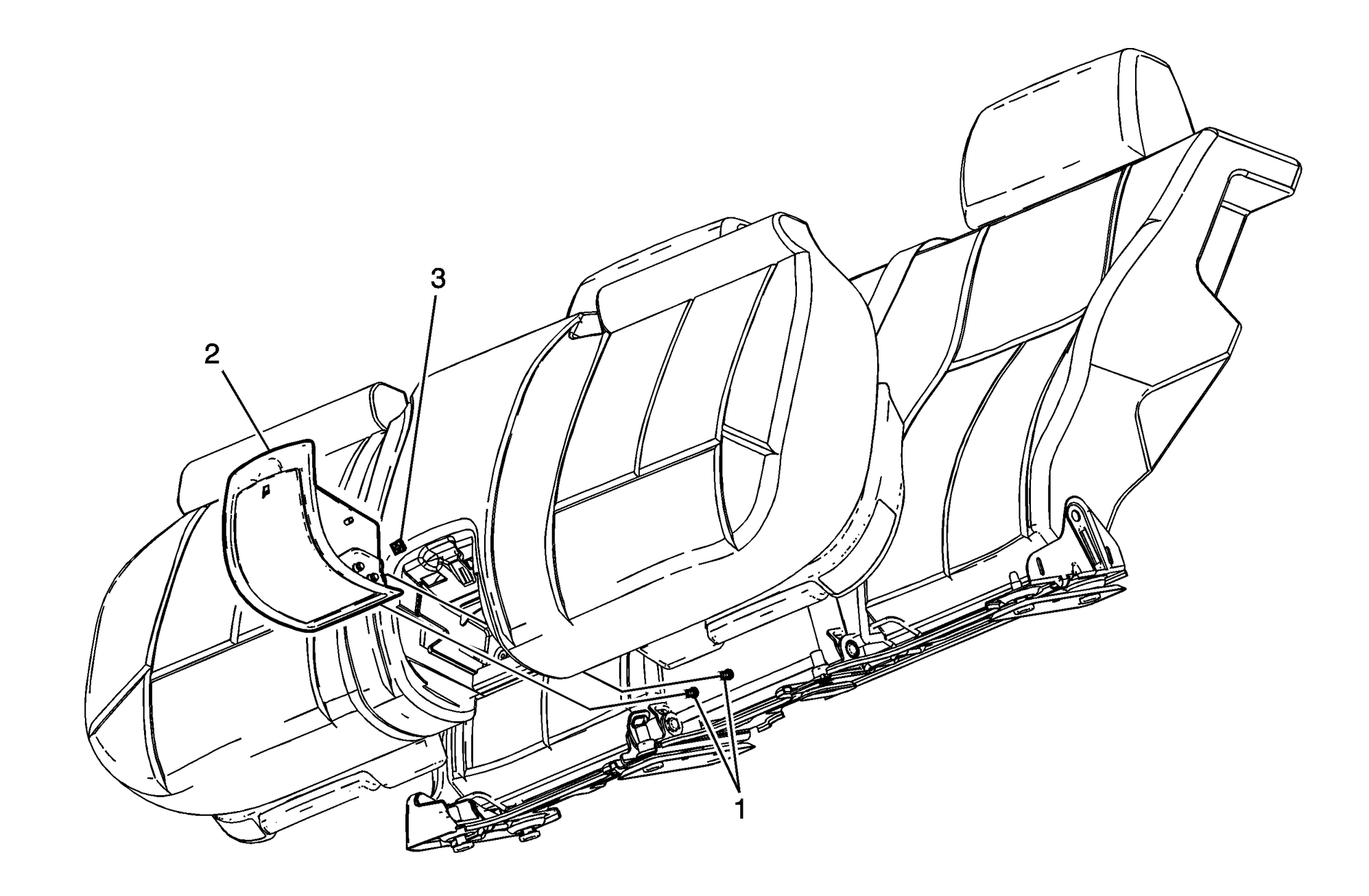

Had the H3 serviced, later found out some tech cracked it.
Regardless, I ordered the base and looking to install it myself.
Does anyone know how to accomplish that?
Thanks.
Old Jun 1, 2018 | 06:30 AM
2006 H3 - Rear Seat Cupholder
Component Name
1 Rear Seat Cup Holder Screw (Qty: 2)
Notice: Refer to Fastener Notice.
Tip: Fold the rear seat cushion forward to gain access to the screws.
Tighten 2 N-m (18 lb in)
2 Rear Seat Cup Holder
3 Rear Seat Cup Holder Retaining Clip

Old Jun 1, 2018 | 04:36 PM
H32006's Avatar
Joined: Dec 2009
Posts: 225
From: Los Angeles, CA
Wish I checked this before I did it earlier!
So, I did figure it out.
I had just ordered the cupholder housing (#17).
Lifted the backseat and saw 2 screws. Removed the 2 screws and it popped out.
What I didn't notice, after I installed the housing is that it didn't come with the screws that hold the cupholder (those would be #16 per Doc's post).
So, took the ones from the old one, was kind of bitch lining it up, but the cupholder is in the housing.
I'm kinda pissed that I had asked my mechanic what it would cost to do, and he quoted me $75. I realize that it is cheaper to do yourself, but with the money I spend there, for 2 screws $75..
Anyway. Good on this. Thanks for the input guys!
