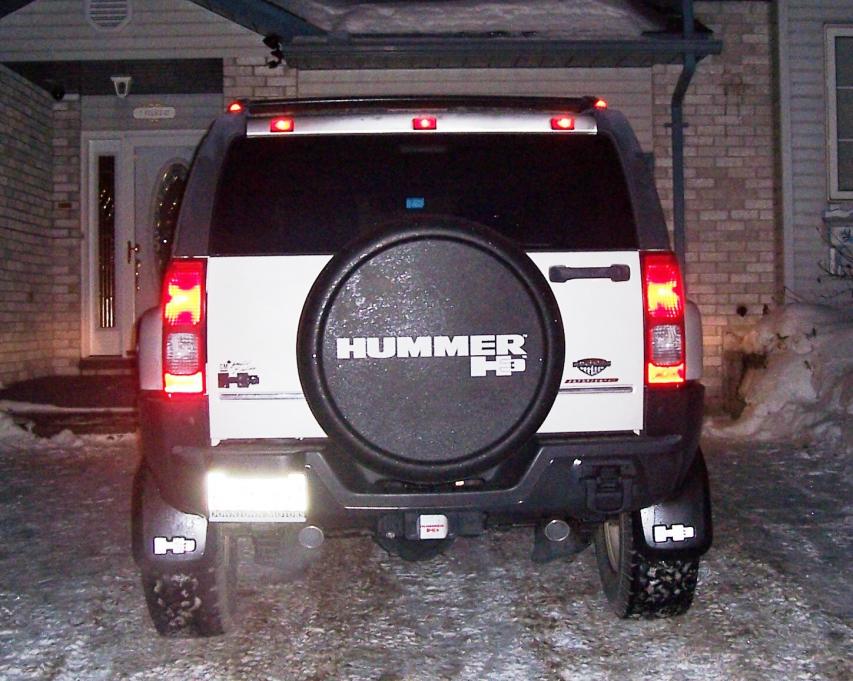

Default dual Billy Boat Exhaust on my ALPHA H3...LOVE IT
i would stay away from removing cats.....can prove to be issues ....I went with a B&B CAT BACK SYSTEM....LOVE IT...GAIN SOME POWER AND THE SOUND IS GREAT..NICE RUMBLE BUT NOT OVERWHELMING..fyi

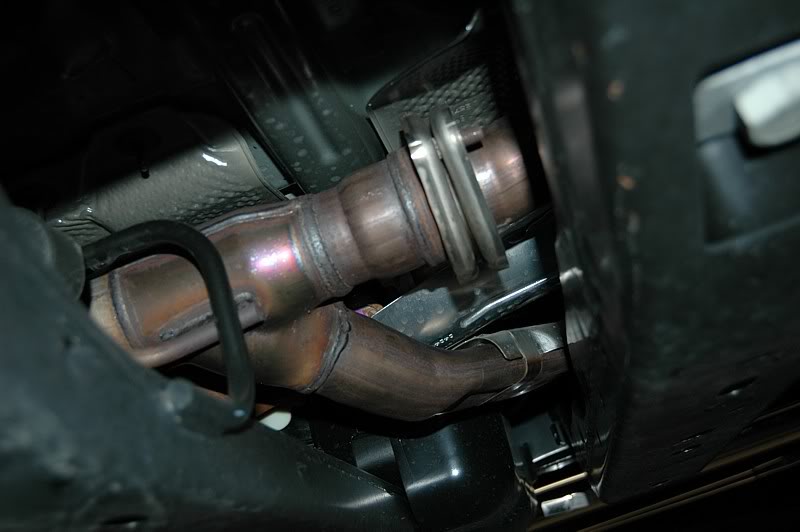

Well, CAT backs help with sound..... and that is about it by themselves. They do flow better so as part of a performance package, they have value.
To get performance out of an Alpha through exhaust you have to get rid of the weak link, right before the Y. The crunch zone could be replaced by a new section of pipes from down stream of the mini cats and out through true duals, or a larger Y for cross over effect split back out into duals.
As to removing the Cats, the O2 sensors are down stream from the front mini cats, so there will be issues there. The main cat can be axed, no sensor back there to read what is happening = no issue.

Just to make sure you understand, you can only remove the rear cat, the front two are monitored by the O2 sensors. The front ones are referred to as mini or pup cats, even though on the Alpha they are longer than the rear Cat.
This is the rear cat.
