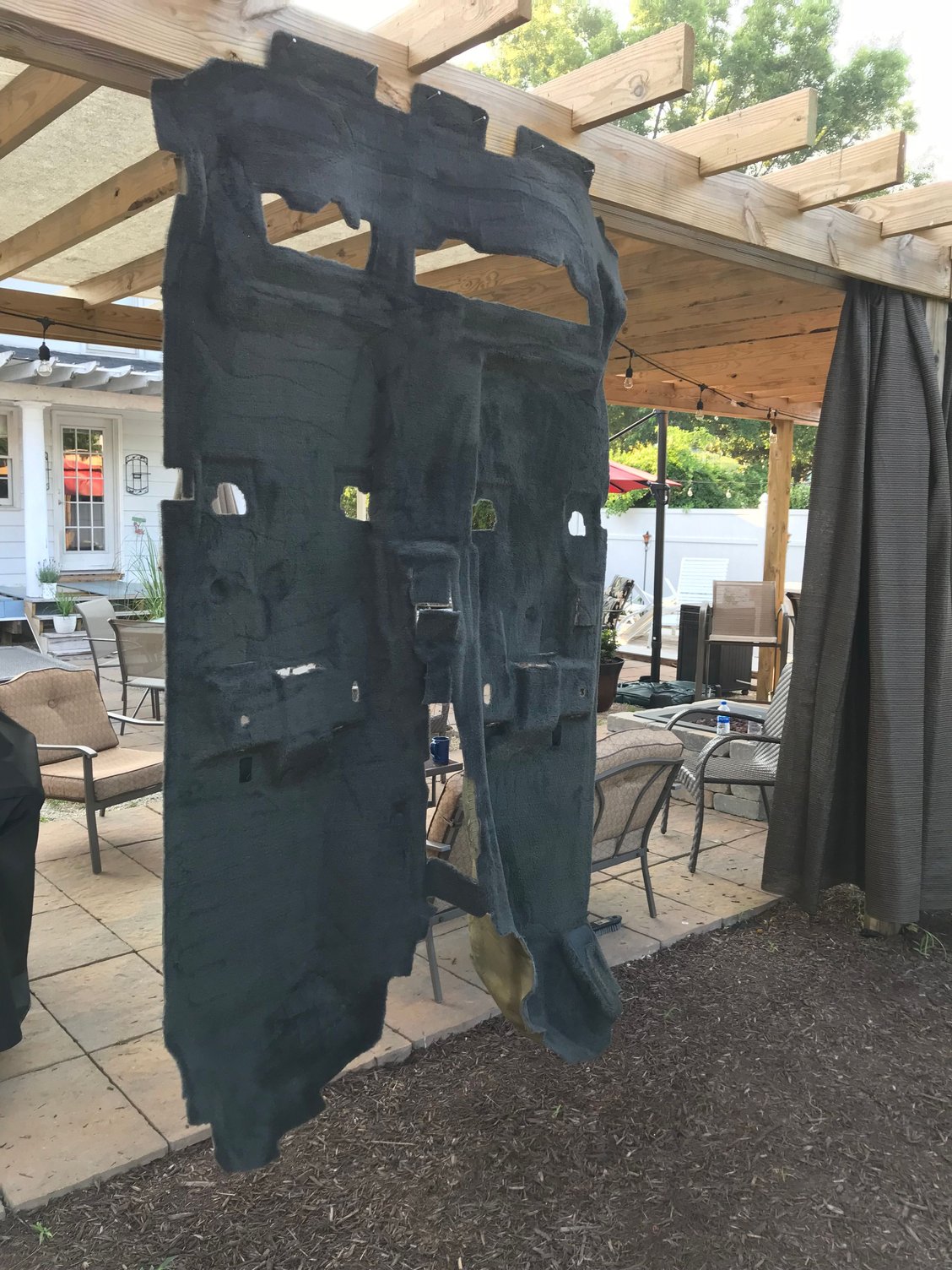

This was all caused by sunroof leak
Old Jul 1, 2018 | 06:31 AM
hummin along's Avatar
Joined: Apr 2016
Posts: 74
Default This was all caused by sunroof leak

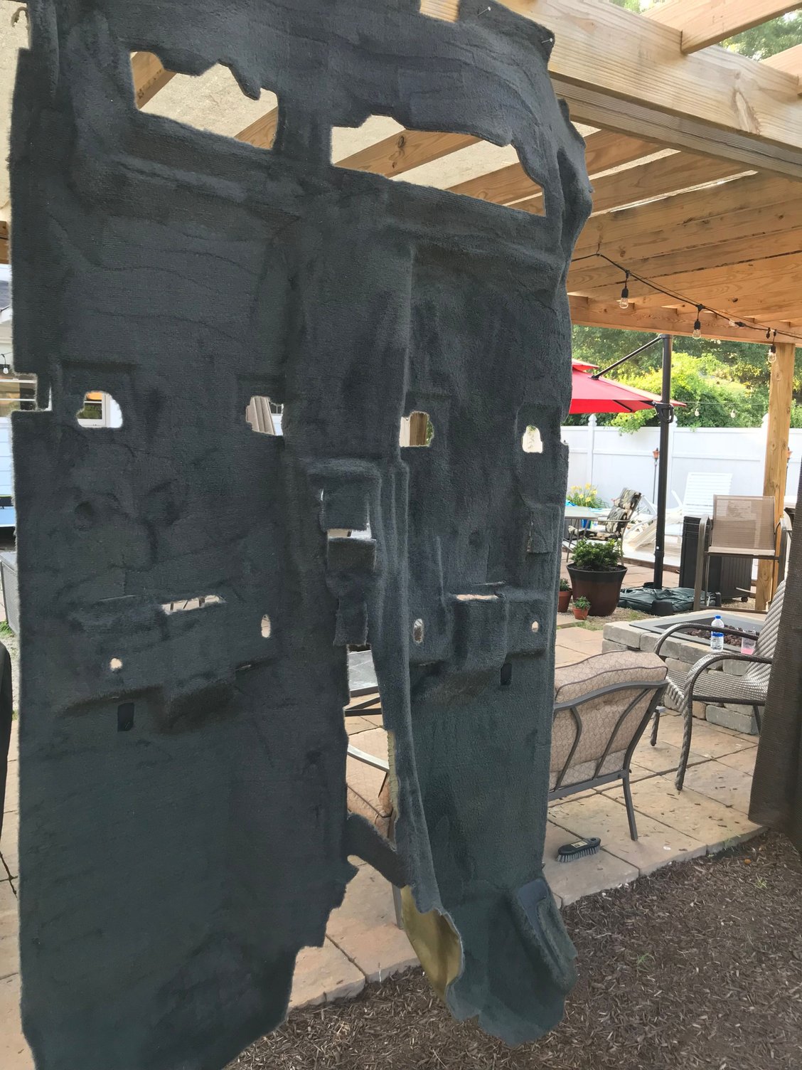

Had to remove carpet. I power washed it, in sun. Back in truck today. Do the maintenance on those sunroof drains. I never want to do this again
Old Jul 1, 2018 | 06:39 AM
Ordieh's Avatar
Joined: May 2015
Posts: 210
From: Texas
Remember to keep a THICK coat of dielectric grease on the seal! Bummer that you had to go through all that.
Old Jul 2, 2018 | 03:26 PM
happythree's Avatar
Joined: May 2012
Posts: 2,005
Default they all leak...
"a little" is normal and silicone grease helps reduce water intake.the drains can handle normal water but if left open,dust and debris plug drains. i never open unless moving. let it sit ,they will plug up.
73000 on my 10,zero plugged drains.
Old Jul 2, 2018 | 04:59 PM
Joined: Apr 2016
Posts: 74
I think I had the same problem on my Supra. I never leave open while not in truck. Actually I hardly ever open the thing.
Will say, looks brand new inside with the carpet cleaned.
