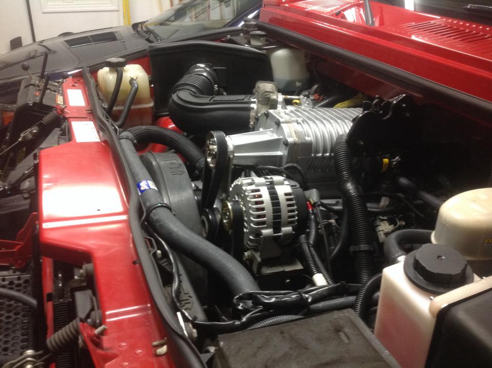

Default Finished
Just finished installing a magnuson supercharger in my 05 two weeks ago. Power difference is amazing. I live in the mountains and now she sails over them. No change in mpg after 500 miles

Old Oct 25, 2013 | 11:43 AM
H2CANEPADESIGN's Avatar
Joined: Jan 2011
Posts: 614
From: N. Hollywood, CA.
It is the **** huh? tears over hills!
