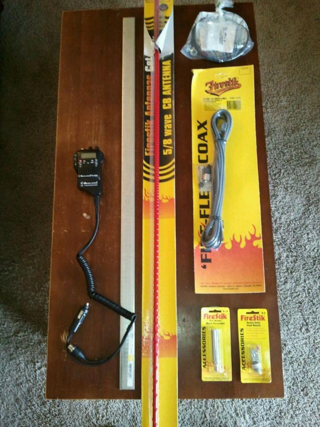

Hey all, adding a C.B. This weekend along with a couple other things, any ideas are welcome.
Yes, I do know C.B.s are outdated. But it's just for trail and mud runs.
Maybe a necessity for a zombie apocalypse also?
Anyway, here's the gear.

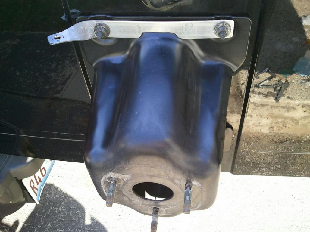

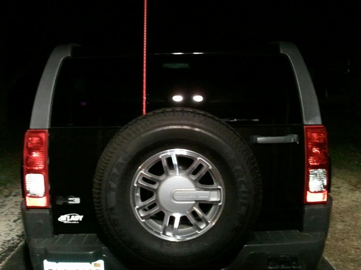

O.K., I built my mount today, and ran my wires through the rear vent. Got the outside all tightened up.
Now, happythree, before I go and run all the wires through the door jamb in the morning, could one of you tell me if I mounted everything correctly. There turned out to be a gap between the Quick Disconnect and the Stud Mount, so I'll trim the mount bolt tomorrow as well.
I'm also am going to ask if I actually need the ground as the coax has ring type mount?
I just don't want to fry anything when I turn it on
It did get late, so the last couple pics are dark. I'll get a couple more in the morning.
Thanks in advance guys.

it seems that a good ground is always good to do.
