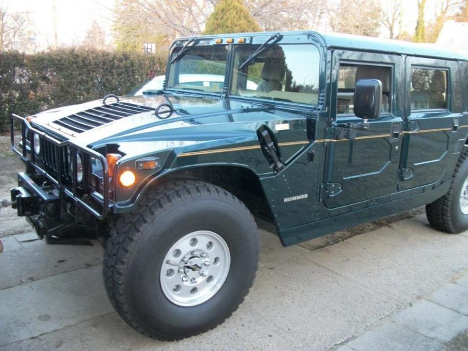

I have similar problem also ,runs fine,engine will stall,pull to side of road,starts right up.,,I was was thinking injector pump.
Attached Thumbnails 98 H1 will starts but stalls after 5 -10 secs.-417663_359198564109147_1235110100_n.jpg
