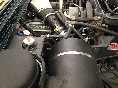

Do you have any pictures of under the hood and under the vehicle?

Default pics
under hood,
Attached Thumbnails 93 H1 with 502 engine and turbo 400 trans-%24_1.jpg   93 H1 with 502 engine and turbo 400 trans-images.jpg

Those are really poor quality pics. You cant see much. Looks like the fan shroud has a chunk missing. And there is no foam sealing the cooling stack- does it run hot / overheat?
