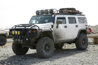

Well.... if anybody tells you that you need a 12" lift for 40's might not be the best person to take advice from....
I have a 6" Fabtech, and I WHEEL 41x14.5-17's....

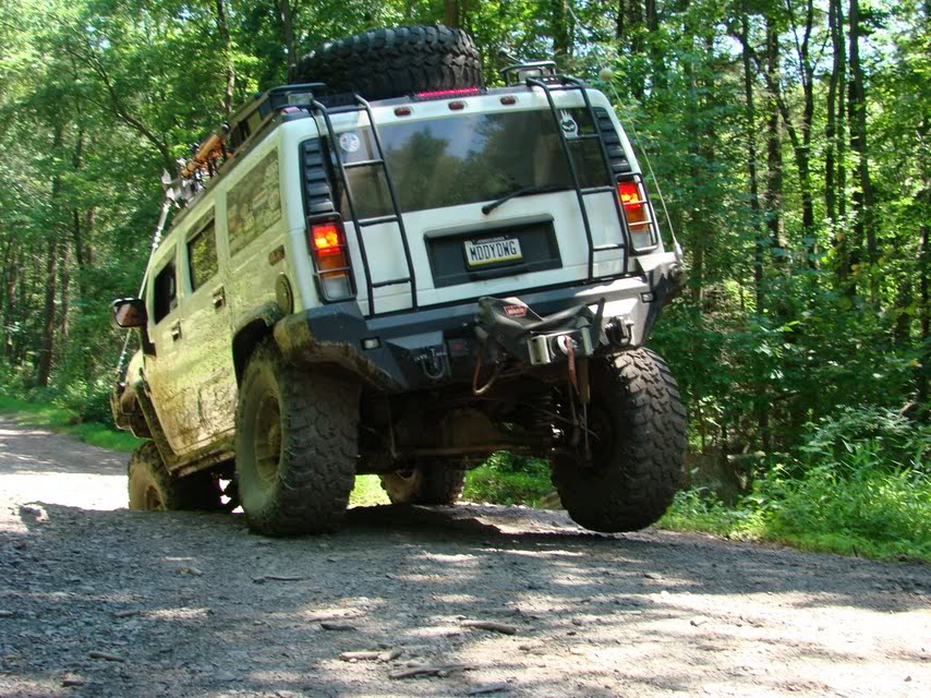

AND.... I have enough flex/room/etc to stuff them enough to STILL lift a tire off the ground....
They never said that, they just said a 12" lift with 46" tires would require a lot of work.
That's a really nice setup and a good looking hummer to boot. How do you like er muddin? Also, why are people saying 40's is pushing it with a 6" lift when you have that much room? Custom work done?
