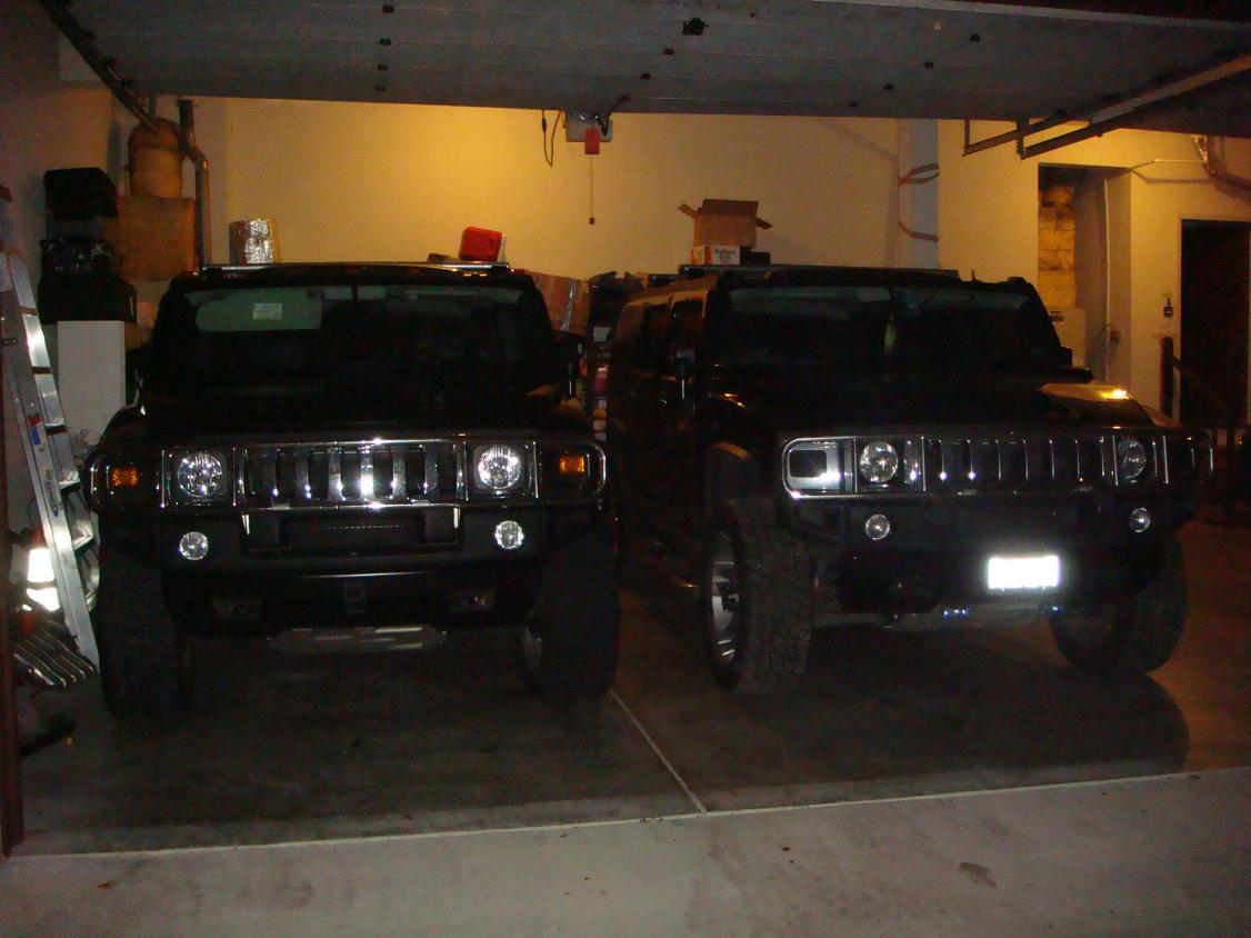

The two beasts waiting to go into service tomorrow!
