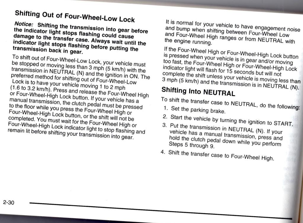

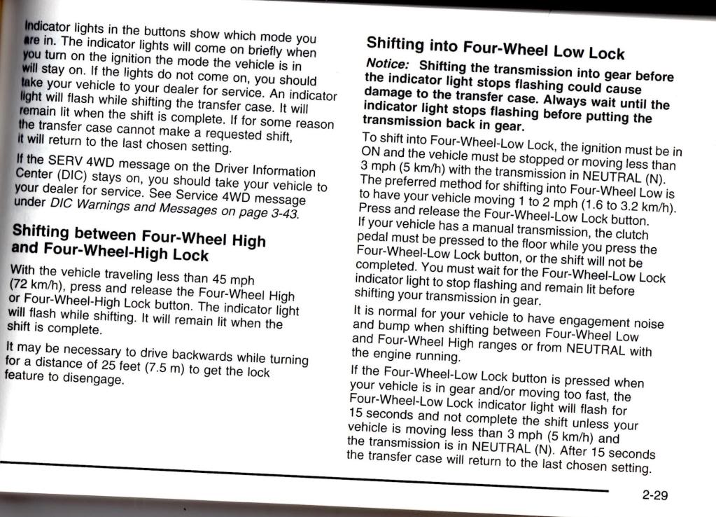

This should help a little.
If this does NOT work then you have a serious issue in your t-case and need to get it looked at!

Thanks for reviving this thread, now i know that I need to drive backwards for 7.5m while turning to switch between 4WD-HIlock and 4WD-HI.
Not every convenient in town.
