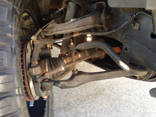

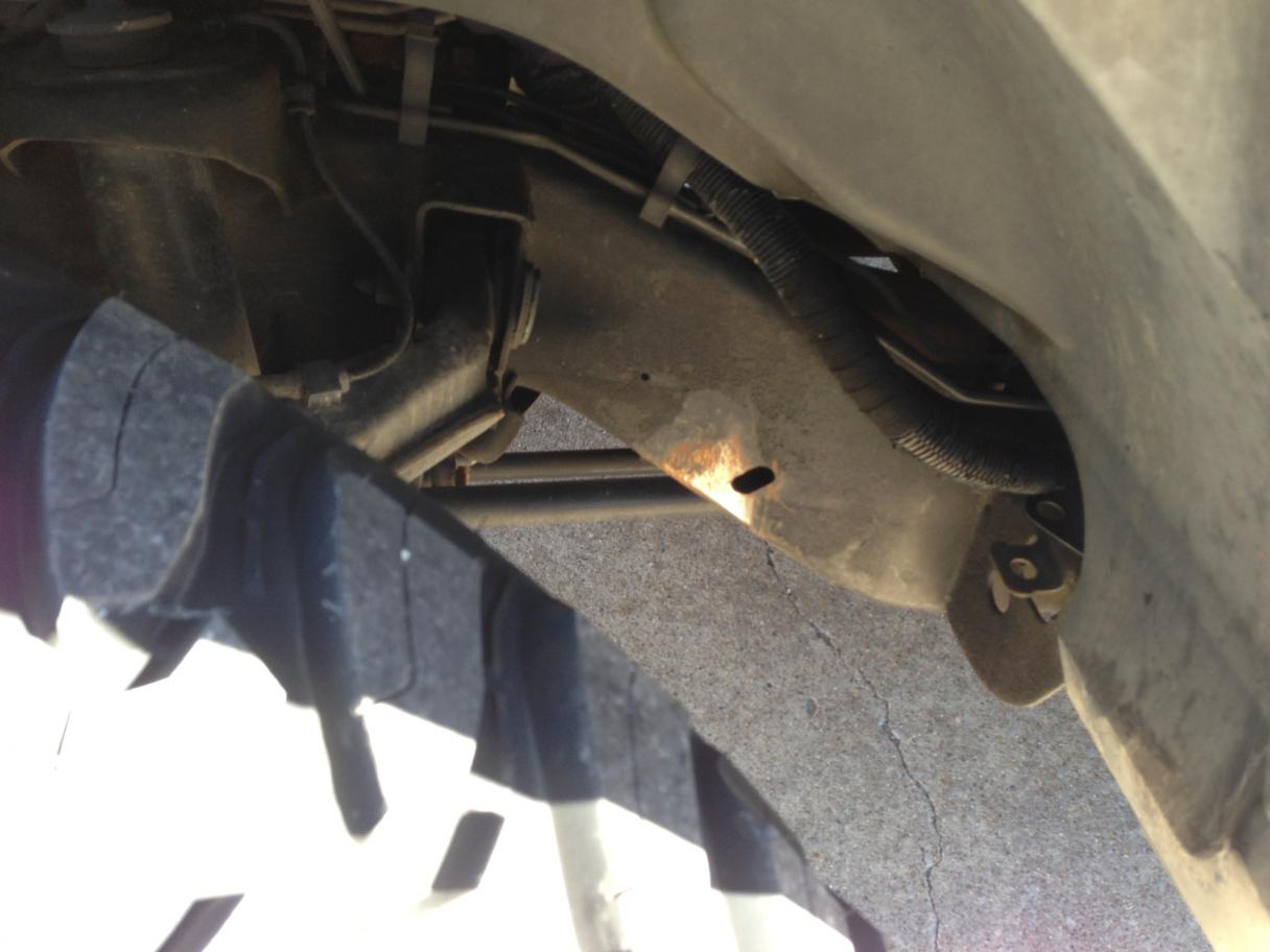

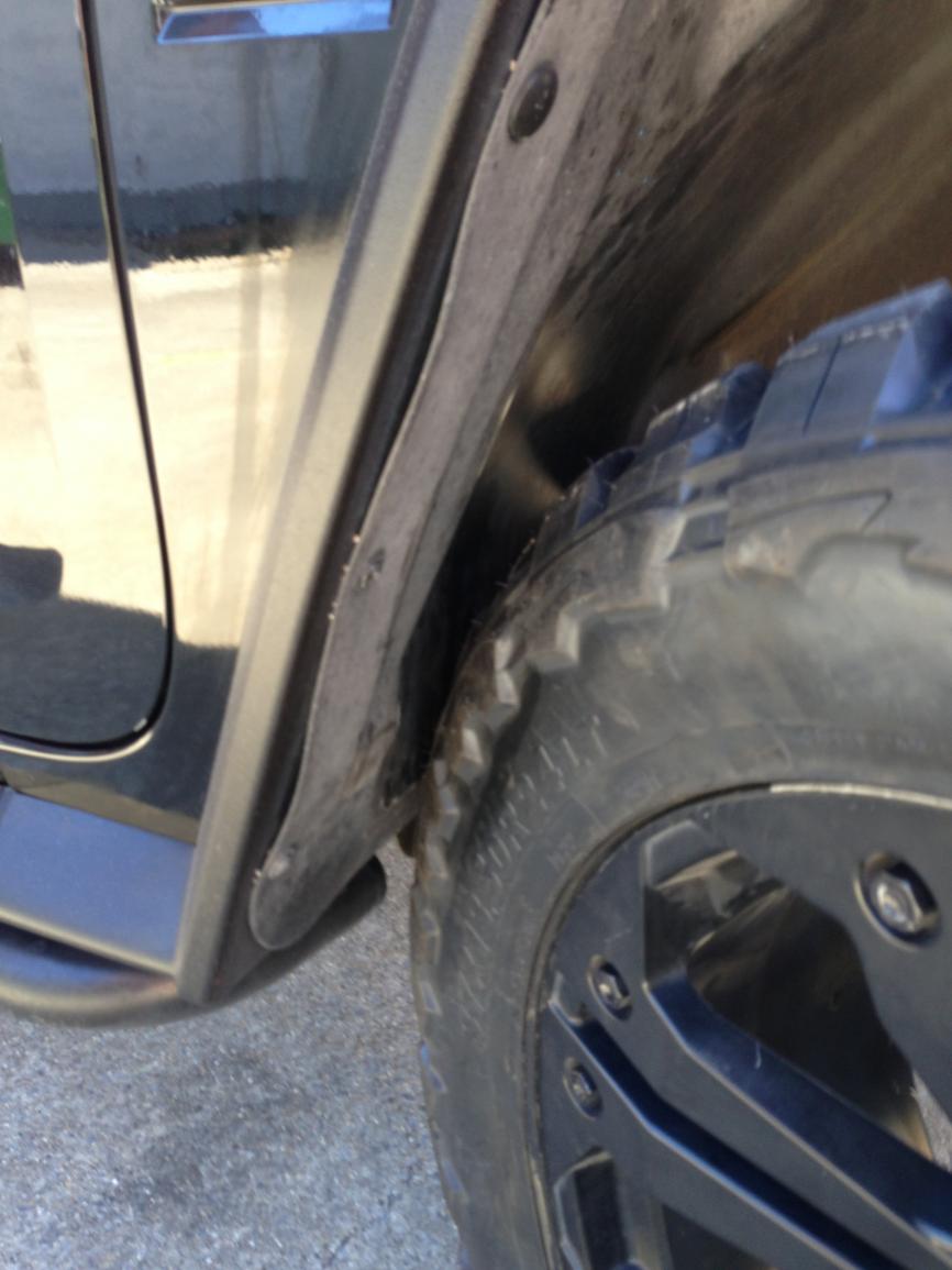

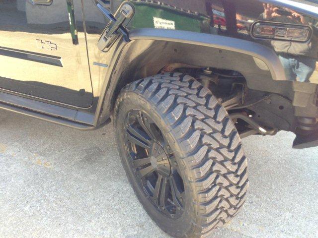

I purchased this 07 SUT in december of last year with 24" wheels and 37" Toyo tires. The front tires were new and the rears were shot I puchased two new tires and installed them yesterday. The front tires were rubbing on the frame and the sway bar in a tight turn. At my tire shops suggestion I order a set of 2" wheel spacers from Custom Wheel Spacers in Colorado installed them yesterday also. Now the tires clear the frame members but rub on the plastic wheel well liners.
What should I do now? Rip out the fender well liners? Do I need a lift kit? Is cranking the torsion bars enough? Keep in mind I have a 7ft tall garage door that I maybe clear by 2" without the rack bars. I can modify the garage but it would probably be cheaper to get smaller tires.

Setting out the wheels with spacers is the only option I have found. The problem is that I needed a 2" spacer to clear the frame. 2" spacers have a second set of stud bolts that have to be re-torqued periodically. This means removing the tire and blocking the hub each time which is a pain. If you are only rubbing on the sway a 3/4" or 1" spacer would do it they are available but you will need longer stud bolts which I was unable to find.

My Question is how much will I have to lift it to clear the fender wells?

I finally balanced the spacing and the tires no longer rub. I installed 1" custom wheel spaces that I purchased from US Wheelspacers. The only problem was I had to saw off the existing stud bolts about a half inch to mount up the rims. My torsion bars are cranked all the way up also. I tried 1/2" and 2" spacers the 1/2" let the tires rub on the frame the 2" spacers let the tires rub on the fender well liners. If I ordered another set I would probably try 1 1/4". At full articulation the tire still brushes the frame slightly. My opinion is the 37" tires require a lift kit and you should buy something smaller. Anybody need any wheel spacers I have two sets for sale. LOL
