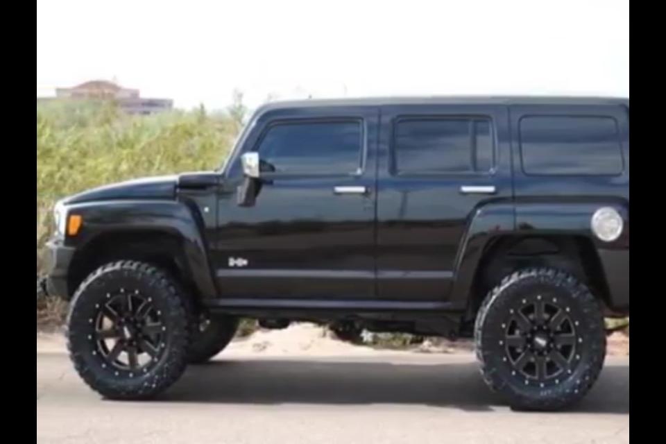

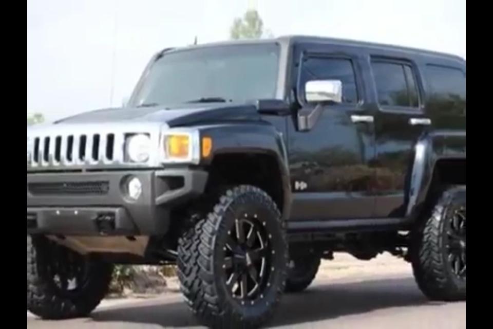

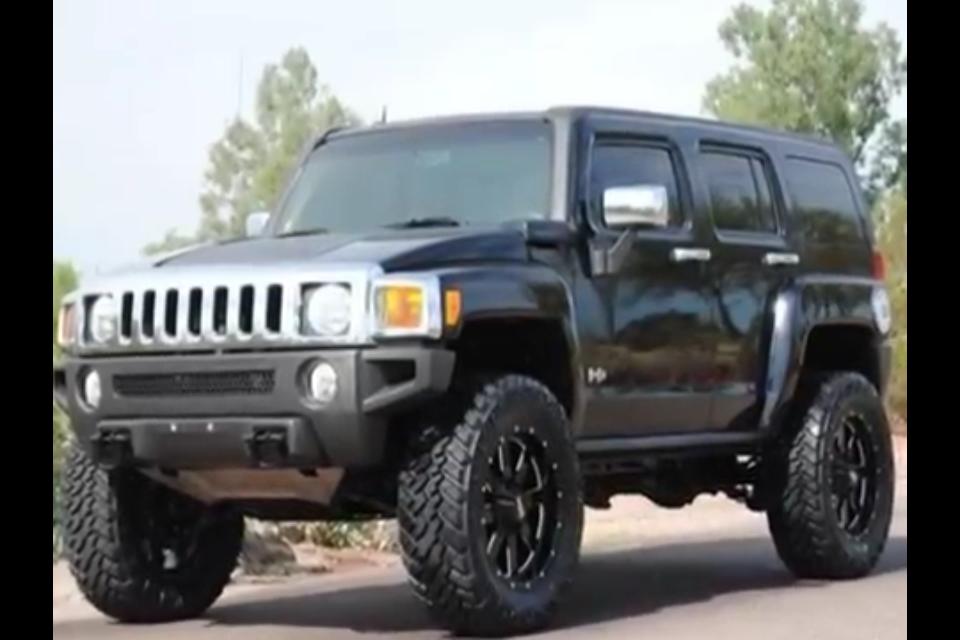

Next month i'll be upgrading my tires to 35" Nitto Trail Grapplers along with Moto Metal 962 wheels. I just cant make up my mind whether to get 18" wheels or 20" wheels. I attached an H3 with 20" Moto Metal 962's and 35's on it. Now the question is 18"s or 20"s?

Hmmm. let me think...........I'd go with 16. Plan on going off road with those tires and wheels? if so then do a lot of reading on offroad performance recommendations, safety, and what sizes the serious off road pros use on trail and street rigs. From the pros and the national safety council their recommendation is to stay as small a diameter that you can. more sidewall more traction and stability. greater grabbing power. It's all there for you. Most people ignore this and do what they want anyway, so take it as it is.

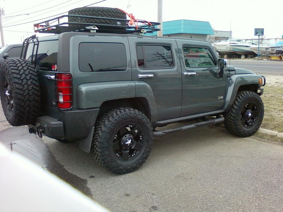

Go with 18's so there is still a lot of rubber for the sidewall, if you off road keep the stock wheels and tires for that. I have 18 rockstars with 35's and i take hunting in the woods and on the beach. If you want to climb rocks keep the stock wheels and just upgrade the tire size. 315/75/16's on stock and 12.5/35/18's on 18x9 rims. My 2 cents

I did get rid of the nerd bars and put rock rails, so I use my tire as a step to put stuff on the roof. The tires will stick out a bit so crap flying up from the road is something to keep in mind with 18's or 20's

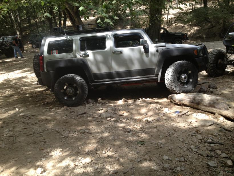

I offroad mine with 18s. I would not do it with 20s. If you offroad go with 18s and no more. if you are set on trail grapplers look into 295/70/18s, this is what I run on XD SPYs. they are close enough to 35s, but are cheaper than the 35s.
