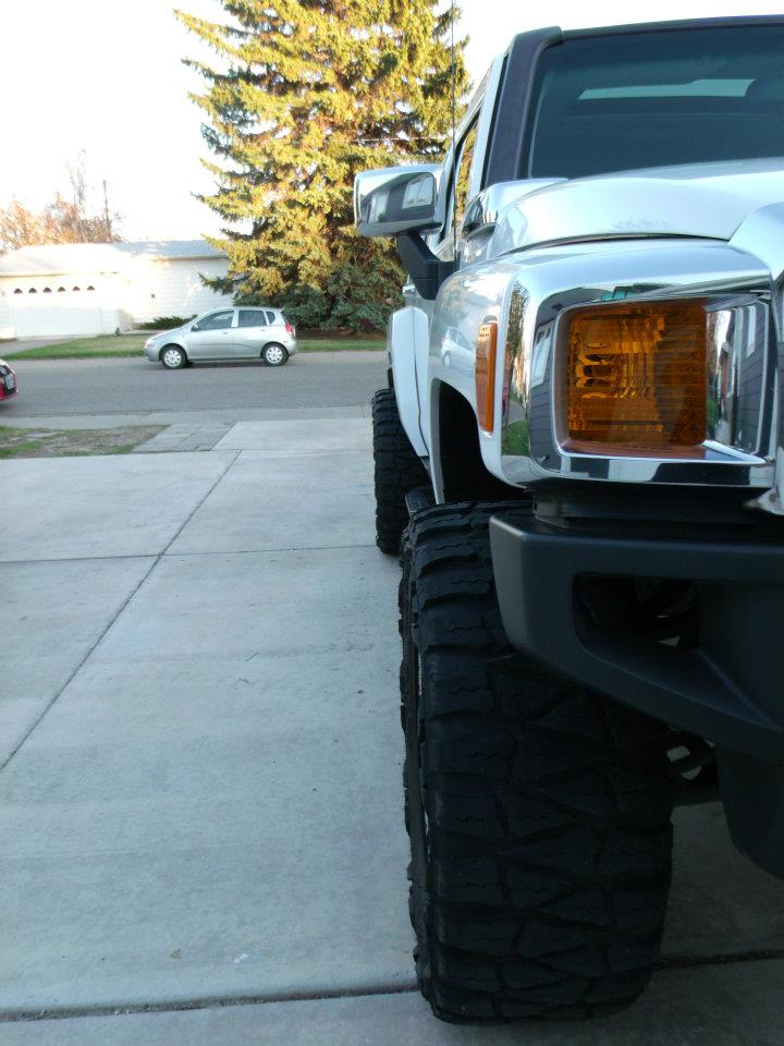

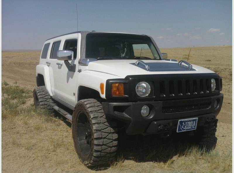

My current wheels have a "stick out effect" and I want to keep that when I get my new tires. Does this mean my current setup is something other then OEM or wrong?
Is there anyway to keep this look when I order my new wheels and tires and be "right"?

It's the backspacing on the wheel that you need to pay attention to. The backspacing on ours is 4.5" I just measured how far our tires stick out past the fenders and it is 4". I had no idea it was that far. I like it with a wider stance like that.

In many states and Ontario, you will get a ticket for tires that stick out beyond 1" from the fender. Then you will be ordered to remove them unless you add fender flares that pass inspection.
You should also ask, what is that offset doing to my wheel bearings????
IMHO it just looks like somebody winged it with wheel offset having no idea WTH they were doing.
