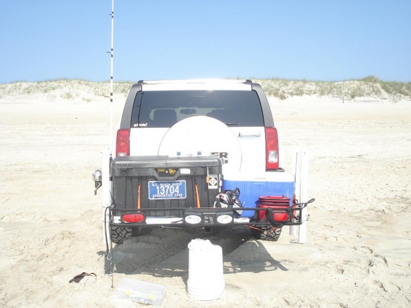

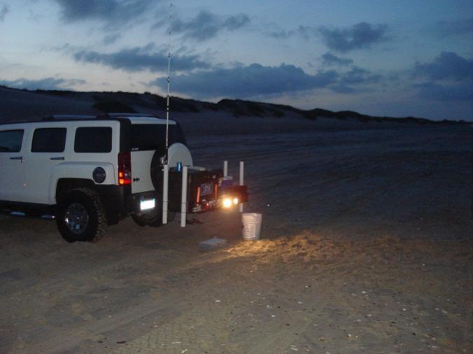

Where did you get the rod rack from? I am going to need to get one before I go to OBX in Aug since I just got my H3. Plus how much did that cost?

All I did was take some 2" pvc and fasten them using u-bolts to my hitch mount cargo carrier (can't remember what kind it is but it came with turn signal/brake lights). Ended up adding two more rod holders this year and used longer pipe to fit the 10'-12' rods. Also added White Knight hitch lights onto the carrier for baiting up at night and rewired the 4 wire stock plug to a 7 pin to utilize the constant 12v the H3 has at the hitch to run the new lights.. too bad the stinkin' bird lovers have the beach shutdown from 10pm-6am everyday now. Just got back an hour ago, got 14.5 mpg over the 1250 mile trip and never had to use the wipers once! perfect weather and cant wait to be back down there over Labor Day again!
Here's another pic of the new upgrades.
