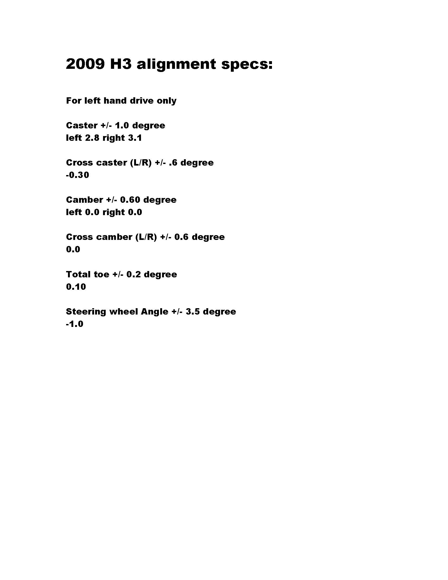

I'm waiting for the 2009 Helm service manual to come out, but I need the 2009 alignment specs for my 3.7 H3 Adventure. I wanted to get the alignment checked since it's pulling slightly to the right and nobody has the specs in their machine. I hope someone out there has the numbers or access to them. I have them for a 2006 but I don't know if they have been changed any over the years.
Old Jun 15, 2009 | 04:36 PM
oruna1's Avatar
Joined: Jan 2009
Posts: 67
I got the info form one of the other forums. Here it is for anyone interested:
For left hand drive only
Caster +/- 1.0 degree
left 2.8 right 3.1
Cross caster (L/R) +/- .6 degree
-0.30
Camber +/- 0.60 degree
left 0.0 right 0.0
Cross camber (L/R) +/- 0.6 degree
0.0
Total toe +/- 0.2 degree
0.10
Steering wheel Angle +/- 3.5 degree
-1.0

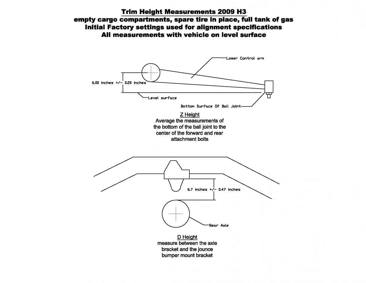

Updated info:
Attached Thumbnails 2009 H3 alignment specs-2009-h3-trim-height-specs.jpg   2009 H3 alignment specs-2009-h3-alignment-specs.jpg
