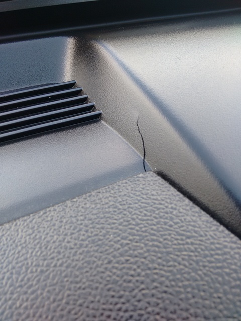

I found my dash rattle in the front passenger door armrest after thinking is was coming from underneath, sounded like u-joints or cv joints or something. Sometimes hard to track those down. You'll have better luck locating it if you can recreate the vibration sitting still. Other wise have a passenger tap on interior plastic while you're driving to see if you can get it to stop even momentarily to eliminate some possibilites... Just sayin Good luck

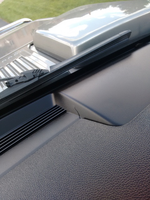

AHH Yes, have a passenger tap on interior plastic while you're driving
IF YOU WEDGE A THIN CARDBORD BETWEEN THE 2 PLASTICS ON THE DASH THE NOISE GOES AWAY.
Old Jul 30, 2015 | 11:16 AM
ant69's Avatar
Joined: Jun 2014
Posts: 118
From: Washington
Oh Man! I said have a passenger "tap" on the dash! Lol! Glad you found it, a little super glue should take care of that. Or if you're inclined there are several products and techniques to fix it. But to do it right it needs to come out to be repaired. search "interior plastic weld"
