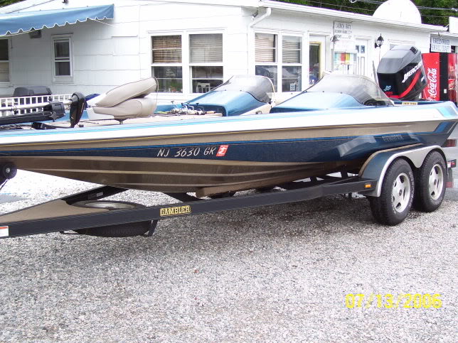

all depends on what your looking for...I tow a 22' boat that weighs about that with no problem......I run around 70-75 mph flat and it drops down to around 60 up long grades. I will say one thing there is ZERO rear end squat in the h3...I was highly surprised and impressed with that.
