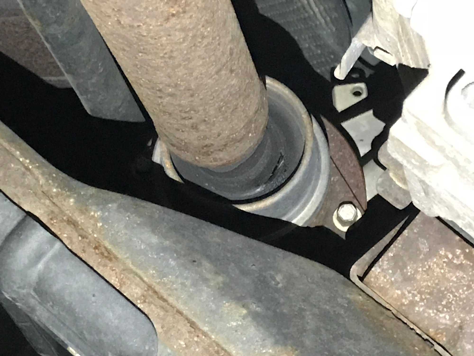

I have a clunking noise in my front right tire area, can feel it through floor not consistent usually making left turns. Checked axel shafts everything looks okay older top control arm bushing though.
while under truck noticed the cv joint boot is cracked on the drive shaft going towards the rear of the truck about midway down from the front.

Hello,
I'm gonna say the front drive shaft joint is in need of repair/replace.
The sweet smell may be a crappy radiator.
The clunky front end will need some hands on verification.

the front drive shaft is most likely your noise i would do that first. you can buy a cardone cv joint to replace it your self. within a hour or two. with just hand tools there is a right up on here on how to do it. you dont need a hole new drive shaft. or remove the drive shaft and then take it to a shop and allso replace the u joint on the opasit end of the shaft

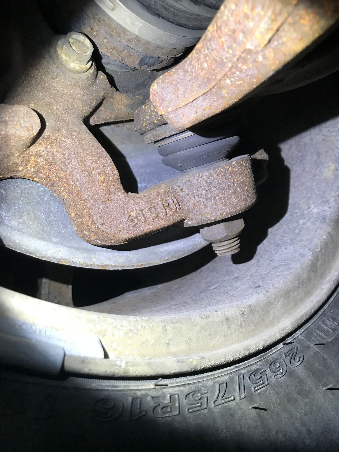

Well seems my right CV axle has play in it a little clicking but noticed bad bushings on both sides and now really worried.
The right on is cracked but still touches comes off frame the left one doesn’t touch at all probably 2” gap. Any thoughts?

Those are progressive dampeners and yours are SHOT! They can be removed with a screwdriver. $15 each on eBay. Part #15783030
Front prop shaft can easily be removed with an 11mm for the front fasteners and a 10mm for the rear fasteners. $240 for a Cardone replacement unit. Don't forget to chalk the tires before removing the prop shaft.
Prop shaft and dampeners are about the easiest R&R on an H3 besides brake pads. What the heck do you need a lift for? Get on you back and take it out. Same with the progressive dampeners. Floor Jack, wheel chocks(blocks of wood, etc.) and a screw driver is all you need.

Well turns out the antifreeze smell went away when running heat, could have been a bad heater core in the past or the used car dealer dumped in leak stop, I didn’t lose any anti freeze but will keep an eye on it. I have a friend doing the cv front drive cv joint and replacing my passenger side CV axle for $250. I ordered the the bump stops or progressive dampeners from GM and I will replace those when they arrive. Hopefully no clunk noise and ride smooths out some. Funny I never thought I’d buy a 11 year old vehicle, I’ve always traded in vehicles before I had normal wear issues.
