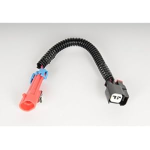

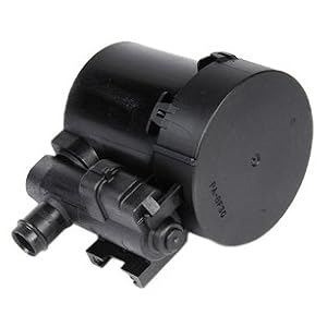

ACDelco 214-2147 connects with factory connector
ACDelco 214-2324 (revised part) requires jumper harness 19257603
Vent valve mounted on canister (#17 in diagram below).
Video on replacement. Remove canister and run hot water over the valve/hose connection, squeeze with pliers to break the nipple off the valve, remove piece from hose, then run hot water over the hose to install on new valve. Mount back on canister and mount back on truck. GL
