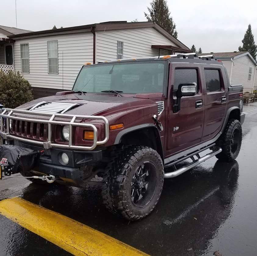

I am installing a new 3 inch leveling kit it comes with the new torsion keys and a 3-inch spacer for the rear coil springs and shock extension brackets is there anything else I need to know

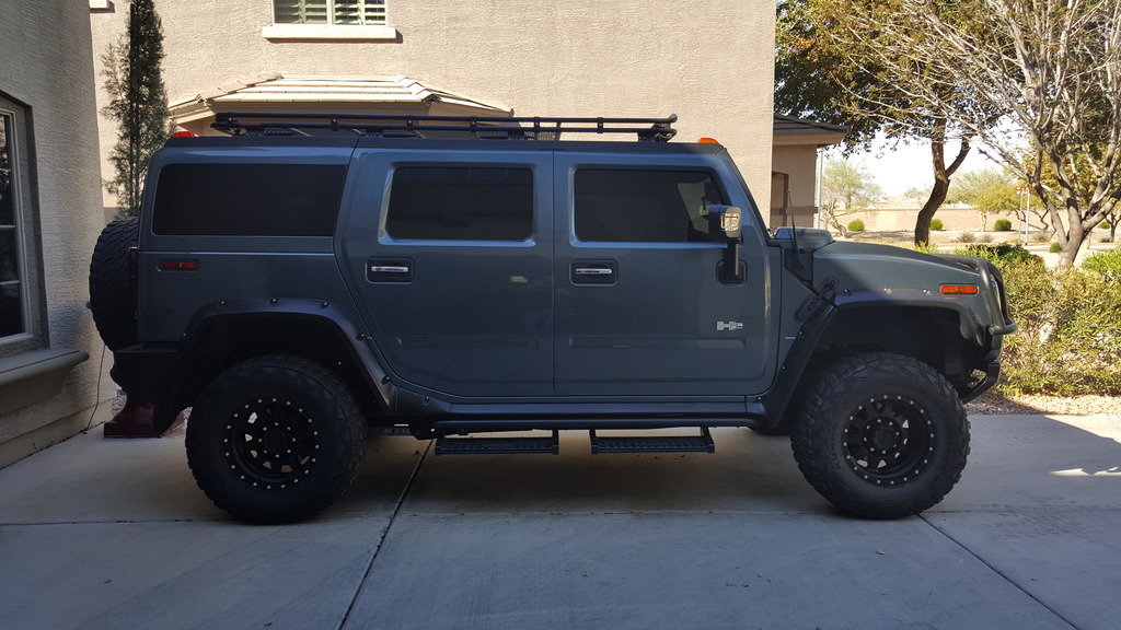

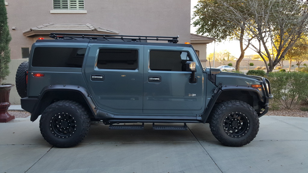

Did you buy the torsion key removal tool as well? I personally wouldn't use a C-clamp or other oddball methods out there. Spend the $35 and get the actual tool.
Also, new keys will level the truck in the front, raising the front around 3" if you place the bolts at the same length they were at with the old keys.
If you add 3" blocks to the rear, you will no longer be level as it will be raked again.

My browser won't let me edit my previous reply.
As you can see, I recently leveled mine.
Adding the GM green keys brought my rig perfectly level
Before:

After:
As you can see if I were to add 3" block to the rear the rig would then have the same rake to it as it did before the new keys.

yes I bought the kit that has the new torsion keys that has the removable tool that actually goes over the top of the crossmember and has two nuts the bolt it up tight and then it has the one bar and it did come with the shock extensions and the 3-inch blocks in the back but I'm just doing the front

I'm not sure if that tool will work, I thought that tool was for later year HD's?

Hotrod56, LoJac is correct about the torsion removal key. Spend the money. There is so much tension on the key that one slip could break bones or kill you.

Did the ride quality change w/ the green keys? It looks perfectly level.
And this is the model number, right? 15592573
Yes sir, that is the correct part number. I ordered mine from GMPartsDirect.co/
Not .com-".co" only. I paid $31.04 each and ordered the key removal tool from ebay for $35.
