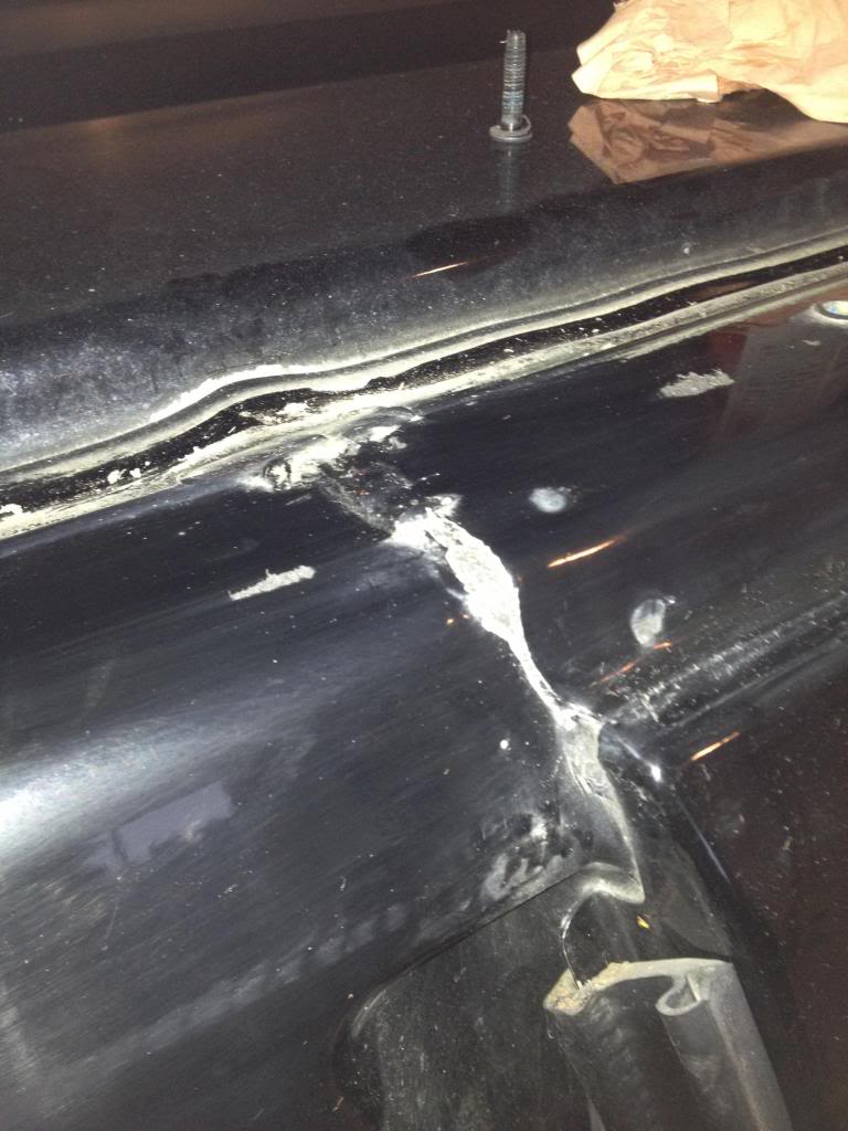

Here is the seams on the hummer roof
I looked at a place that was a little glue or sealant in one place so there is a risk that it's bad at any point and then it will enter water ....
I have taken all of my roof rack mount where i can I find a seam behind the back door

nice if it worked out with water leakage in the car .. I have removed the roof rack mount and wash clean the seam to add there sealant. Take a picture of the seam or send a picture to me at
