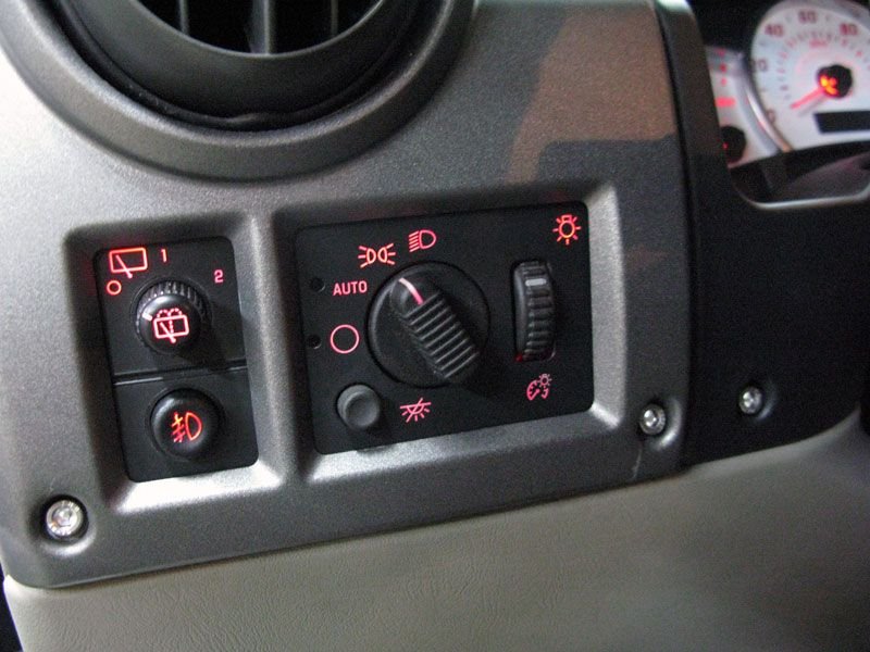

Decided to go with the red led
Old Jan 12, 2019 | 05:57 PM
That is what I did on mine.... only thing is I'm going to have to redo the cluster to add brighter and/or more as the red is dimmer and makes it hard to read at night.

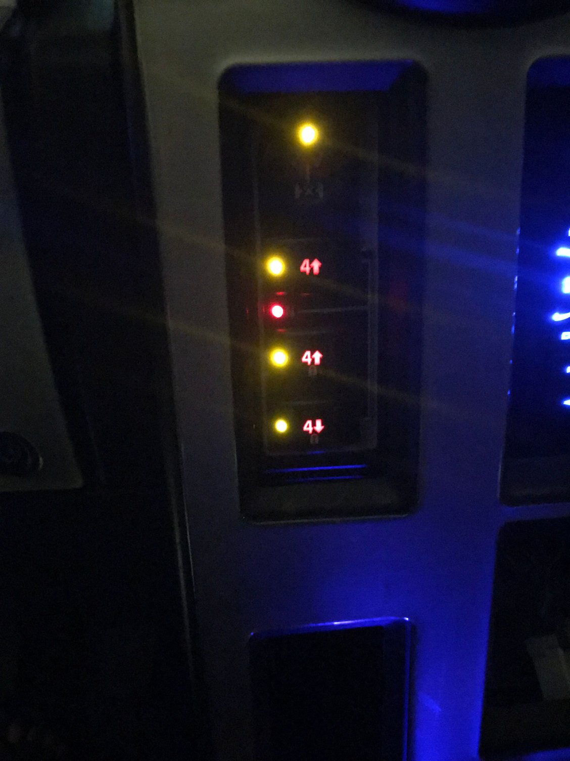

Hi MixMan,
i just checked and the lock button doesn’t have the translucid cover to let the light trough... Have you already thought of a solution?
Old Jan 15, 2019 | 08:33 AM
I was not aware of that issue. That does complicate things some. That being said, as far as I can tell on certain other buttons of that style that they might be painted black inside to block light and ones that light up have an almost blue color applied to allow light through and give the blue/green stock color. Its possible that you might be able to scrape some on the inside directly under the icon. I'm not sure though and I'd have to take mine out to see myself.
One thing I did just check though - GM trucks use a physically identical 4WD selector switch but the top button is for a different function on the trucks and SUV's. Physically they are the same though and on my GMC truck the top button "AUTO" does light up. Since my truck is apart right now I took a quick look and opened the button panel up. My thinking is that maybe we can get a 4WD switch panel for one of the GM trucks and then just use the internal clear light guide part to direct light to the top button on our Hummer ones. That is however dependent on if some of the coating inside the button can be cleared away to allow light to pass through it. Couple of pictures of the one for my GMC truck. You can see that I changed it to red and you can see that there is a light guide to direct light to the top button and that the top button has the light blue looking spot where AUTO lights up. I never really paid attention but I also see that 4WD is not lit, only the word AUTO.
