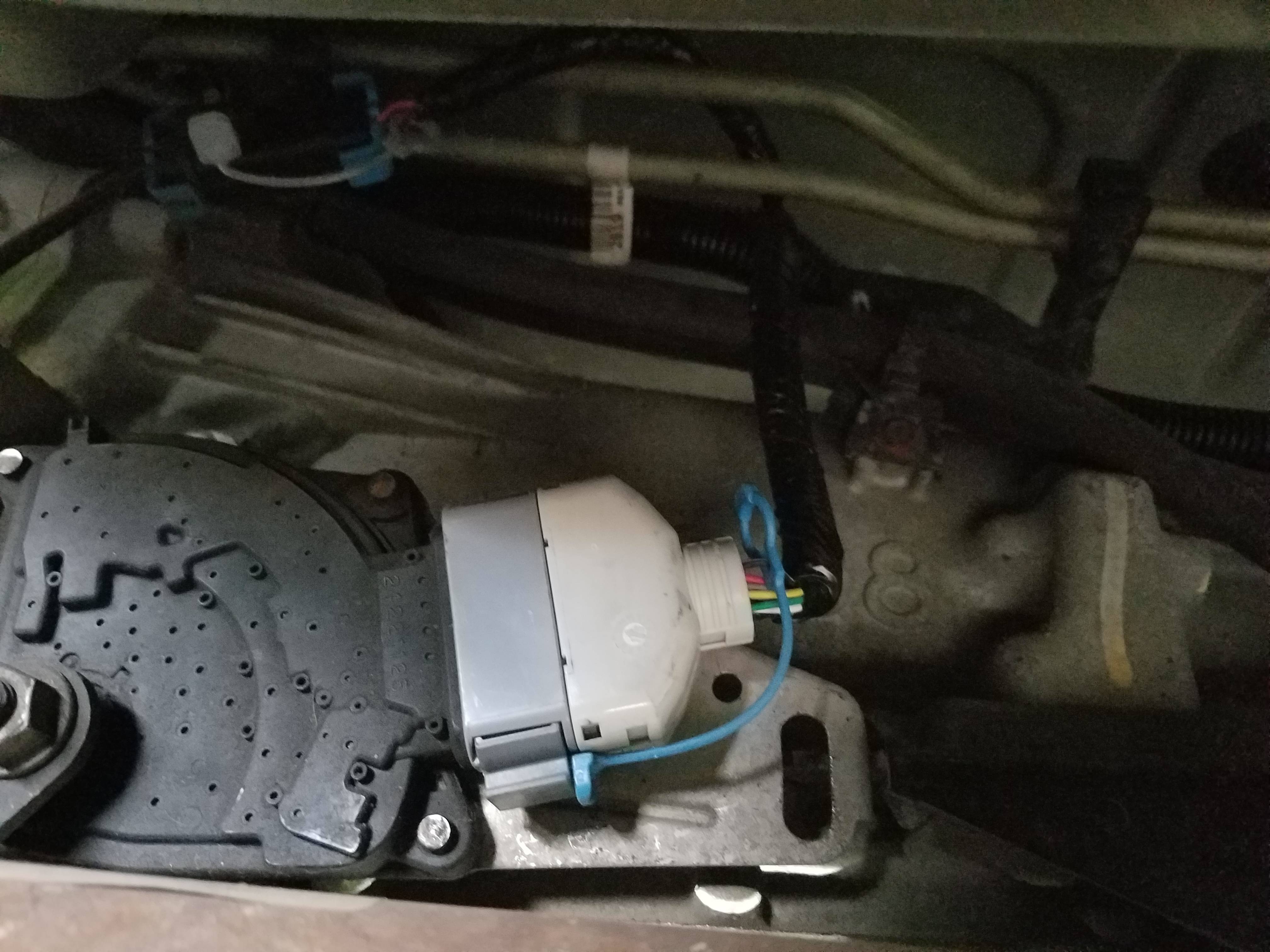

Is this the transmission connector? If so i pulled this and packed dielectric grease in the female side connections then took for test drive with no improvement....where is the other end of this connector?

Ok, so nevermind that pic above... i found the transmission connector on the other side and it was actually brand new harness that was replaced by the dealer.
I pulled it and packed dielectric grease and reconnected, took for a test drive and maybe im just optimistic but it only did the surge for a fraction of a sec.....thats great but ill do some more driving to verify.
My next questions are:
whats the proper way to grease these weather pack connections?
Where does the other end of this transmission connector go to? (ill start greasing everything)
