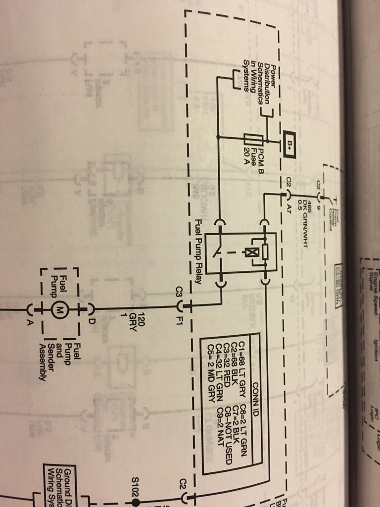

Old Nov 6, 2016 | 07:05 PM
flyday58's Avatar
Joined: Jul 2015
Posts: 329
From: Cloudcroft NM
With a fresh fuse can you hear the pump run, or does it blow the fuse right away? Sounds like you are getting closer...
Old Nov 6, 2016 | 07:23 PM
HUMTECH's Avatar
Joined: Mar 2016
Posts: 190
If the pcmb fuse blows as soon as key is turned on disconnect connector at fuel pump and see if fuse blows with key on, if not fuel pump is junk. If it still blows with pump disconnected you have problem elsewhere in circuit.
Old Nov 6, 2016 | 07:54 PM
flyday58's Avatar
Joined: Jul 2015
Posts: 329
From: Cloudcroft NM
