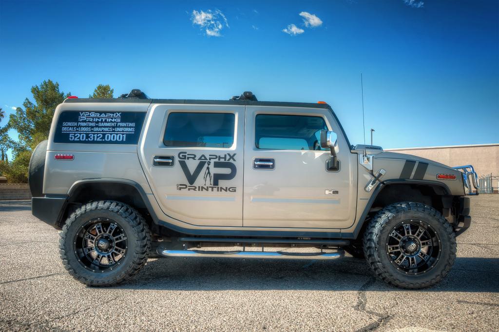

I have 20x12 -24 with togo 35/12.50/20 on stock height with NO rubbing at all....
Looks like you also got an H2.
In any case, nice ride.

From: new Brunswick Canada
I have no idea what size or how far. But i am loving those rims!!!!! What kind are they? I can see xd but that is it.
Old Jan 29, 2013 | 07:13 PM
H2zona's Avatar
Joined: Dec 2012
Posts: 23
The are the new xd 809 riot just came out in January
