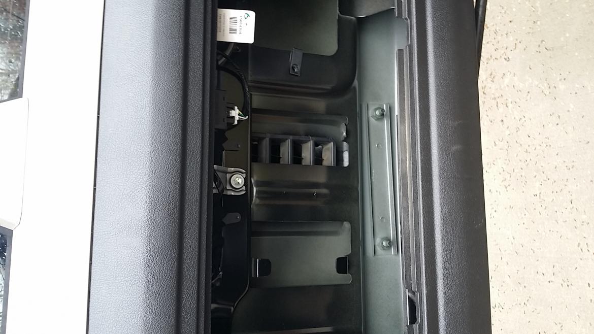

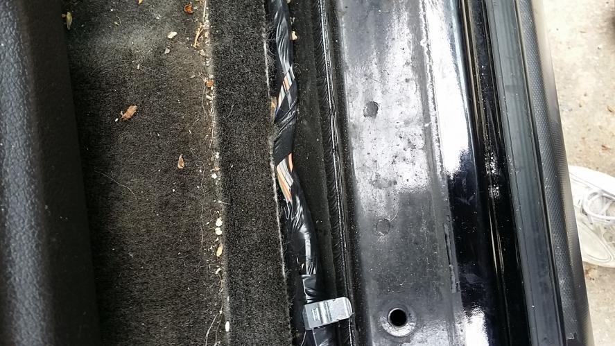

With that all done was surprised to find a nice deep channel running from front to rear cargo, will easily handle the power, pre-amp, and speaker wires.
I plan on running the power lead, amp turn on lead,nd front preamplifier lead down the driver side channel.

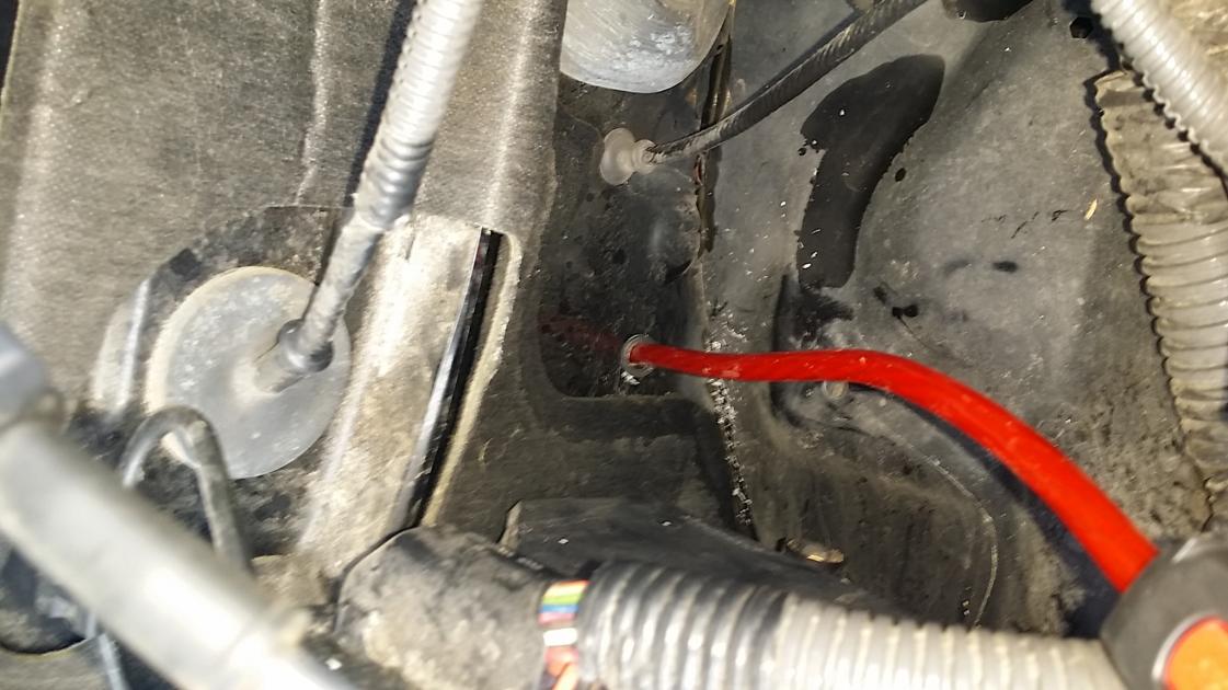

Reason being, the power lead has to get to the battery from the cab. Under the dash you will see the hood release cable where it penetrates the firewall. You can easily drill a hole 1" to the right side of that and be well clear of any obstruction either inside the cab, or in the engine compartment, and the battery is on the same side..

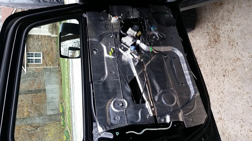

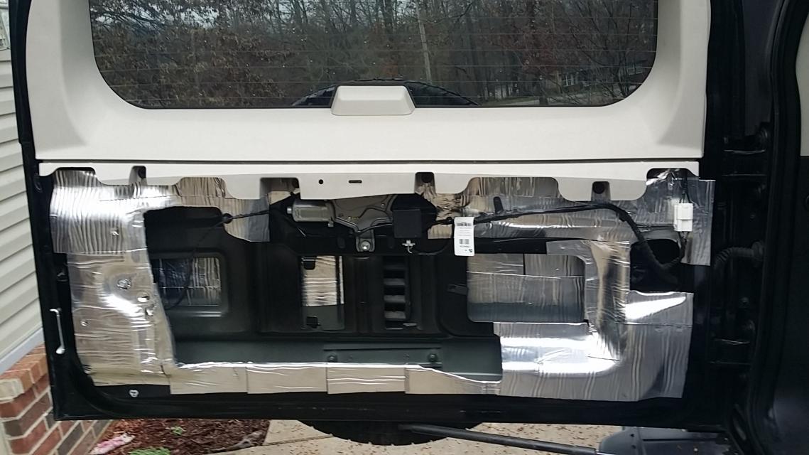

Sound deadening is installed in cargo area sides and door. No surprises there at all. A fair amount of disassembly, but basic skills and good trim panel tools will get you through easily. And yes you have to manhandle the rear cargo panels to get them off.
Door panels where a breeze, sound deadening finished on driver side, and front pasenger side.
Time to get this far: around 6 hours.

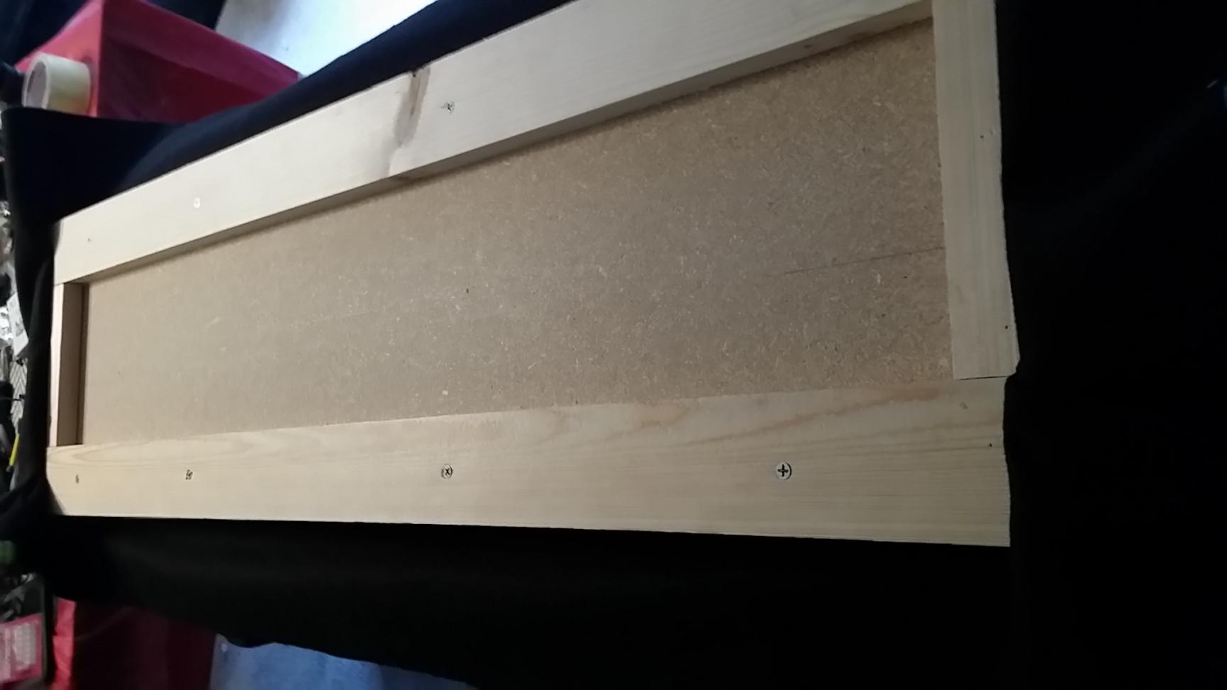

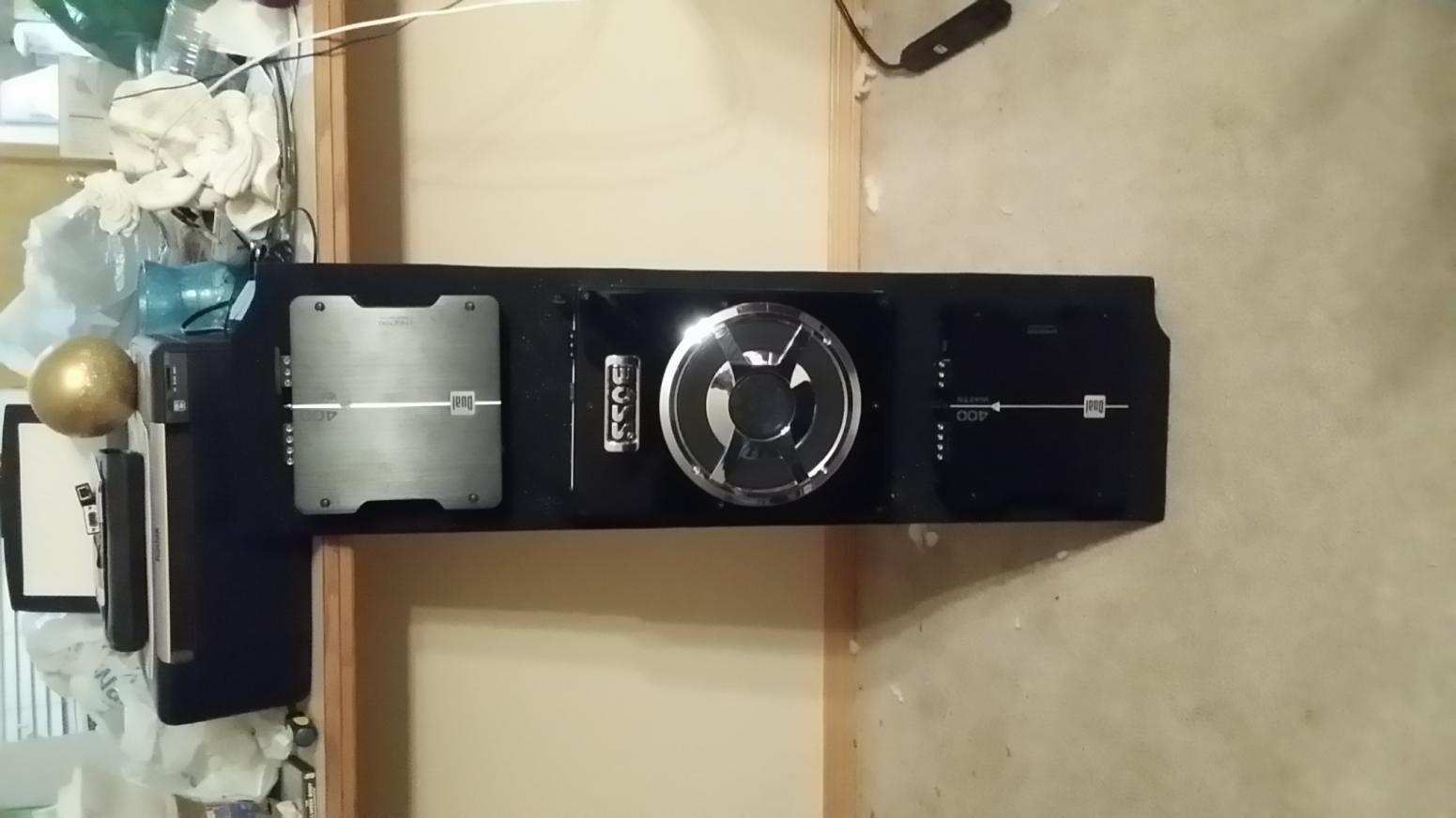

Mount for the amps was a 12"x42"x5/8" mdf. I screwed some 3/4"x2" pine strapping along the edges, then layed down a base of sound deadener covered this all up with a piece of black felt from the local wally world. Stapled it all along the furring strips (strips go on the bottom).
Mounted the amps down on that.

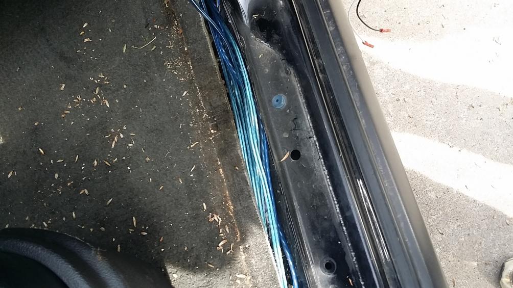

This now sits behind the rear seat and gets fed with the power leads and preamplifier leads hidden in the channels.
Amp speaker leads are 14awg (50' spool) and fits perfectly with no waste. Used EFX shielded 12' for the pre amp feeds, rear on passenger side, sub and fronts on passenger side.
Main power for the amps (6 awg)hides niclely in the driver side channel with the turn on wire, and the rear pre amp cable, all speaker leads and the front and sub pre amp cables, run down the passenger side. Pleanty of room On each side, fully concealed.

nicely done, I just saw this post or I would have chimed in for ya, but you did everything just the same as I did (except the amp mounting, but thats kind of dealers choice). I mounted my amps in the little cargo cubbies in the back, I think they look nice there. There's a lot more room under the plastic panels along the door channels than it looks like, no trouble getting all the power/RCAs to fit under there. I ran a 6ga power from battery to the back (drilled the same hole into firewall as you did, got a universal firewall grommet to keep it neat) and then into a power distribution block, and 8ga from there to the two amps.
